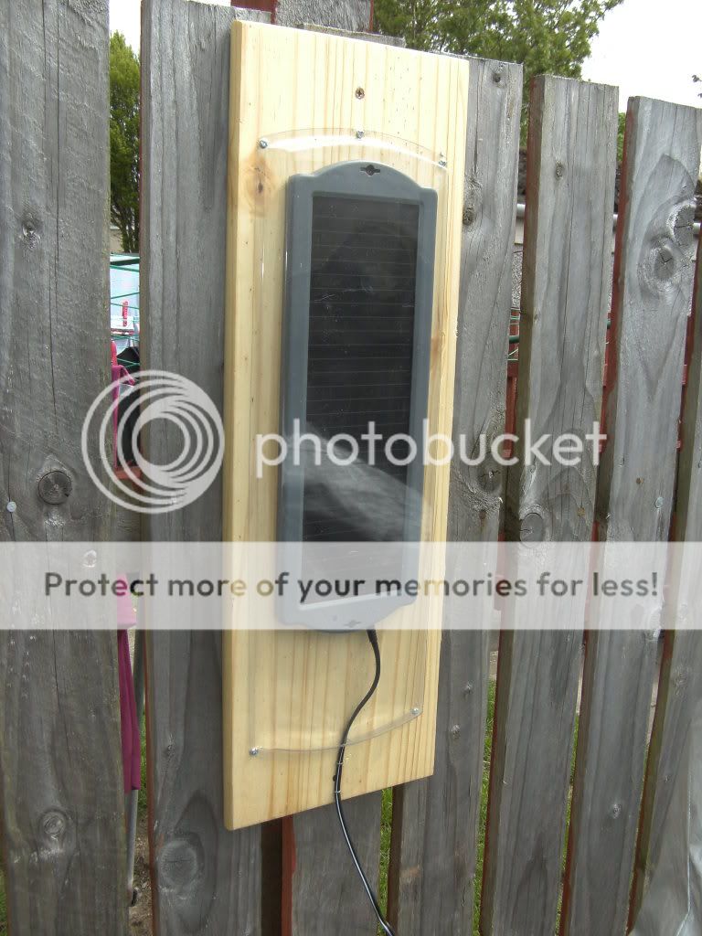

https://i749.photobucket.com/albums/xx132/wwmcintyre/photo40.jpg
My ride lies out all winter, connected to this from maplins £10.
Won't charge from flat but maintains fully charged battery.

The one in my photo is mounted on a wooden panel and covered by the clear plastic wrap that it was supplied with. Has been outside for 2 years and the bike 'jumps' into life even after lying out for weeks in the Scottish winter. A blue flashing LCD light which shows it is charging flashes away even on cloudy rainy winter days
