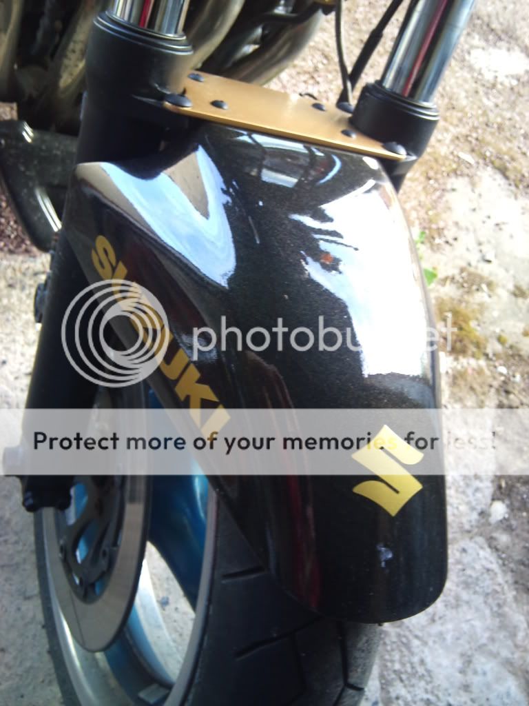

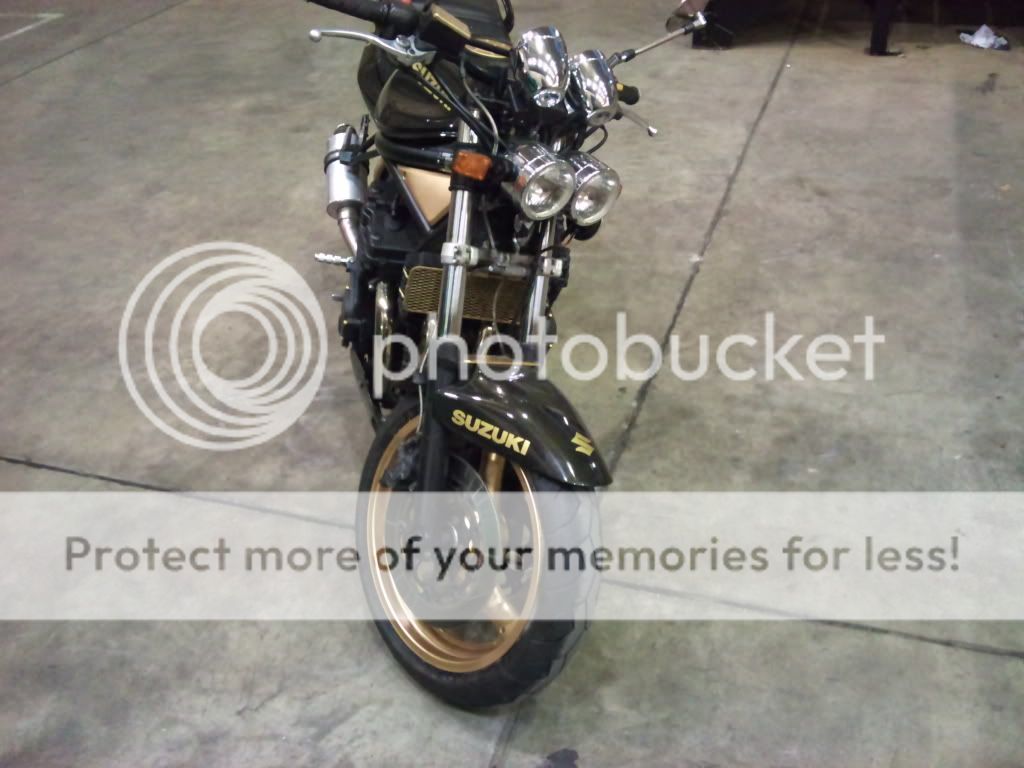

Morning people, need to replace the fork seals on my B6 98 bandit, but its got a gsxr 750 front end, and dont know what year the gsxr is for the size of the seals, is there any way to find out, or easy way?

A couple of pictures would be a good start Thumbs Up

https://i220.photobucket.com/albums/dd63/puremagic72/newly%20sprayed%20b6%2098%20Bandit/DSC_0009.jpg
https://i220.photobucket.com/albums/dd63/puremagic72/newly%20sprayed%20b6%2098%20Bandit/DSC_0056.jpg
Thanks all, they are 41mm.

Prise/lift the dust seal and you'll see the fork seal, as said it'll have the size marked on the top of it.

Thats an old GSXR750 front end if it is indeed that, most GSXR750 after like 92?? were upside down forks, google 1989 GSXR750, that has RWU forks, 1992 brings up USD forks...

Could also be a set of 400 forks. GK73a or 71f as opposed to 76a as the 76 was USD.

Waste of time guessing, you need fork length, disc spacing and offset, caliper mounting, spindle size etc etc to have a hope of identifying them, could be anything.... GSXR750 up to 1990 (went USD down in 1991) or any other number of Suzukis. Just get the size off one of the ones on the bike.
