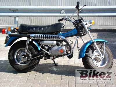

rv90
https://www.bikez.com/pictures/suzuki/1976/10506_0_1_2_rv%2090_Image%20credits%20-%20Knarf%20Knireprah.jpg

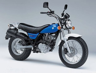

rv125
https://www.tradebit.com/usr/manuals/pub/9002/suzuki-rv125-van-van.jpg
