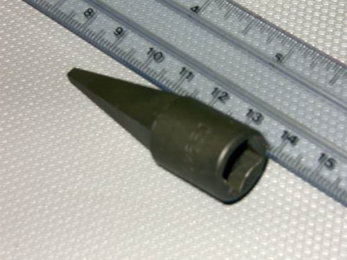

Can't remember from when I did one years ago but I've still got the manual and that says use a dowel with a pointed end so it probably is a round hole not a hex. You usually get better results grinding the end of a metal rod to a "pyramid" shape if it is a round hole as that grips better, bit like the Suzuki fork tool I've got and probably used to do the Honda.
https://i561.photobucket.com/albums/ss60/mickcbr1100/tools/ForkTool.jpg

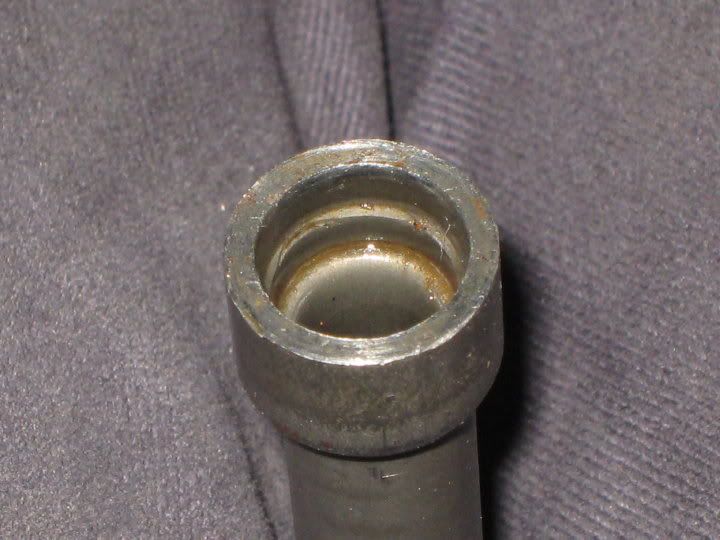

No sadly, the damper rod doesn't have a shape for a tool to fit.
This is the top end of the damper rod in my H100A....
https://i2.photobucket.com/albums/y27/clivejameson/IMG_2829_1.jpg
I had exactly the same problem with mine...a wooden dowel that was small enough to fit down the tube wasn't man enough to grip it without snapping. In the end i found a steel bar long enough to reach and shaped the end to blunt point that would fit into the top of the damper tube. It still needed someone pressing down on the bar really hard while the assembly was held in a vice to stop the damper rod spinning while i undid the bolt!
Mine was an S and that's got a 10mm hex hole, there must be a difference in either models or later years Depends what the O.P's got could be either type.

Bezzer wrote:
true, true
