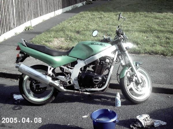

shame you didn't have a before picture, well will keep an eye out to see the wonderful improvements you make Wink

Bishbash IIPosted: 15:30 - 01 Feb 2011 Post subject:
Just for you i remembered i got this one photo on my facebook.
https://www.bikechatforums.com/files/old_gs.jpg

OMG, no wonder you wanted to redo the bike, such a dreadful colour!
