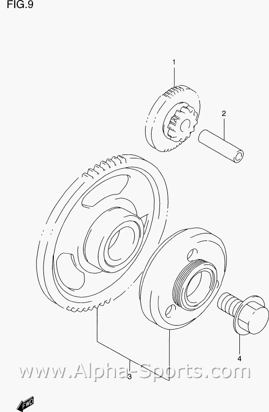

This is the starter clutch 'fiche, the gear on the end of the starter engages with no 1 then the main ring gear, the nut shown is the one that can come loose and lets everything spin on the tapered shaft. If you do take the cover off and everything is loose on the shaft smooth if with emery/wet & dry then loctite fhe shaft and the nut which should be torqued up to 150nm. It's better in the long run to use a proper gasket not sealant as there's always the chance you squeeze the excess into the oilways which will cause problems in the future.
https://www.alpha-sports.com/spst/1998%20GSF1200S/56.gif
One last thing before you start stripping, your battery is good I take it?? make sure by using a jumpstart just to prove beyond doubt it isn't lack of cranking power.
