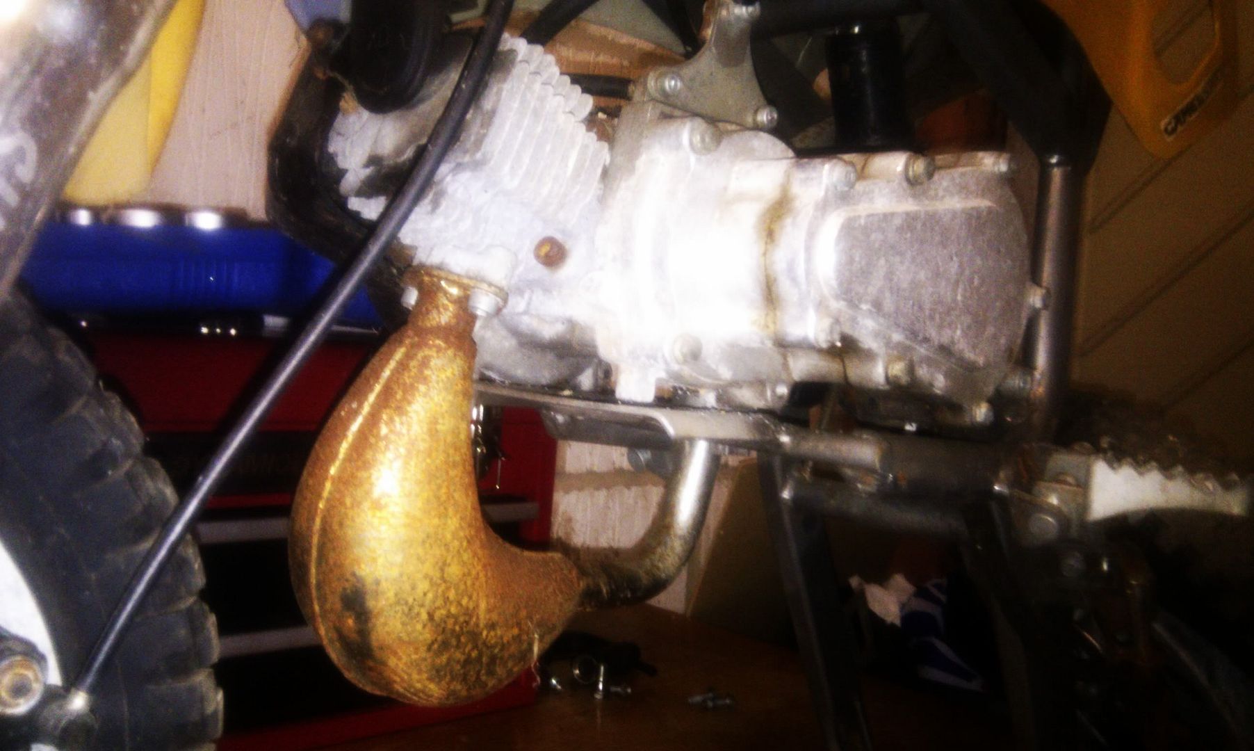

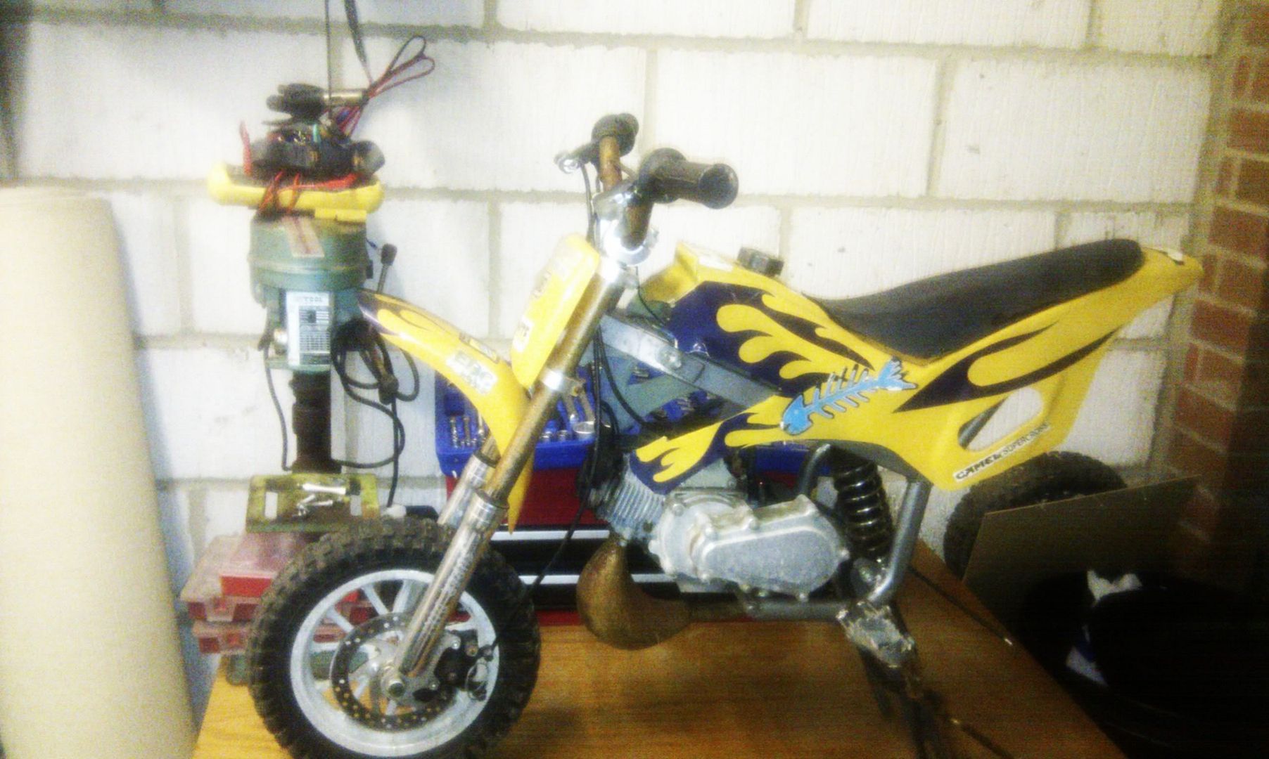

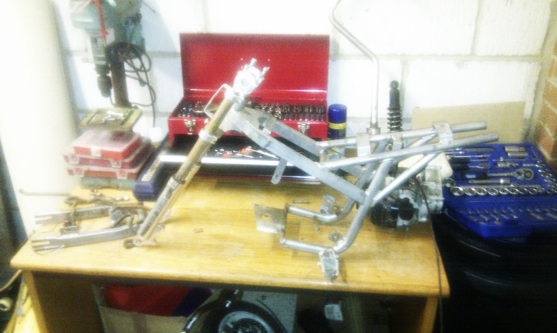

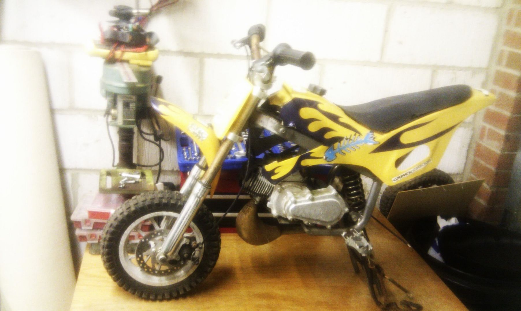

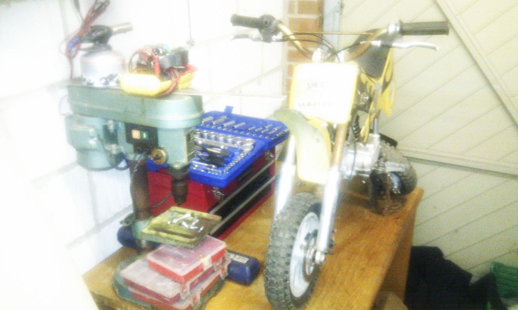

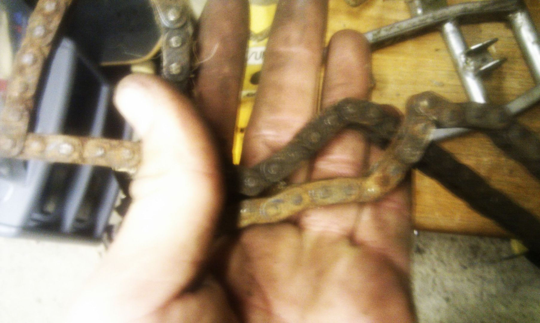

Had a monky bike for a while now, it got used a fair bit then put awy and forgotton about, untill last night! Decided im going to get it going again.

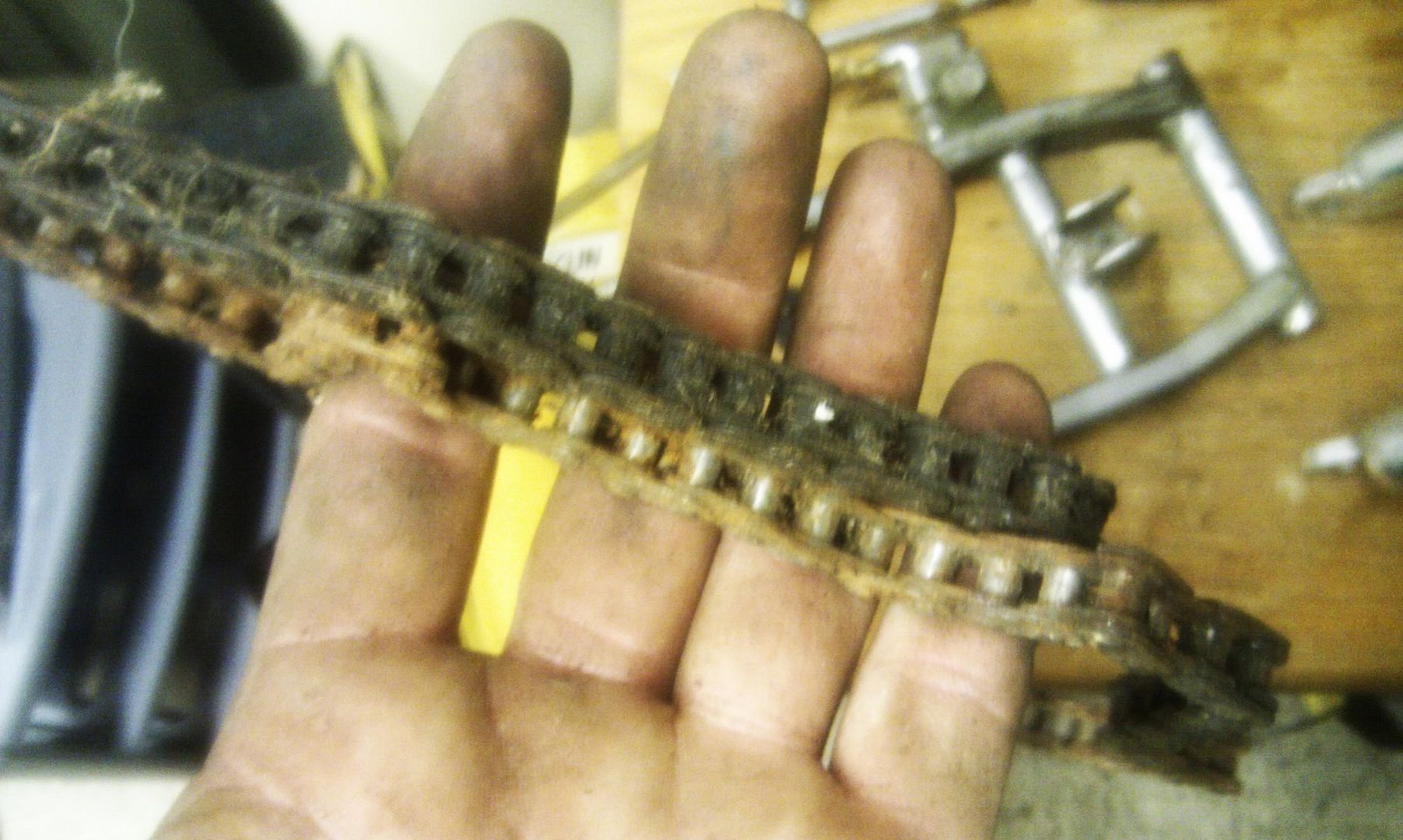

How do I dertimine what chain I need?
Im thining red frame and black plastics..

Ruuuude, I rememeber that thing! bodging the CBR shock in? Did the chain snap? If not just soak it in some kerosine for a few days, wire brush it, then soak it in some used engine oil for a while... its only a panzy little thing, wouldnt worry too much about the chain!
1996 gsf600n (sold)
PostPosted: 19:42 - 09 Aug 2011    Post subject: Reply with quote
Count the links and eghey for mini dirtbike chain. Mine was 61 links.
