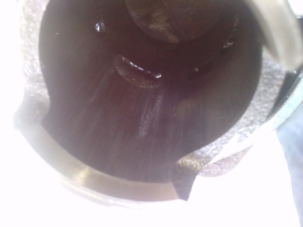

well, ive set to with the spanners, its not looking healthy. I think the oil pump may have died, the supply line to the carb is bone dry inside Sad

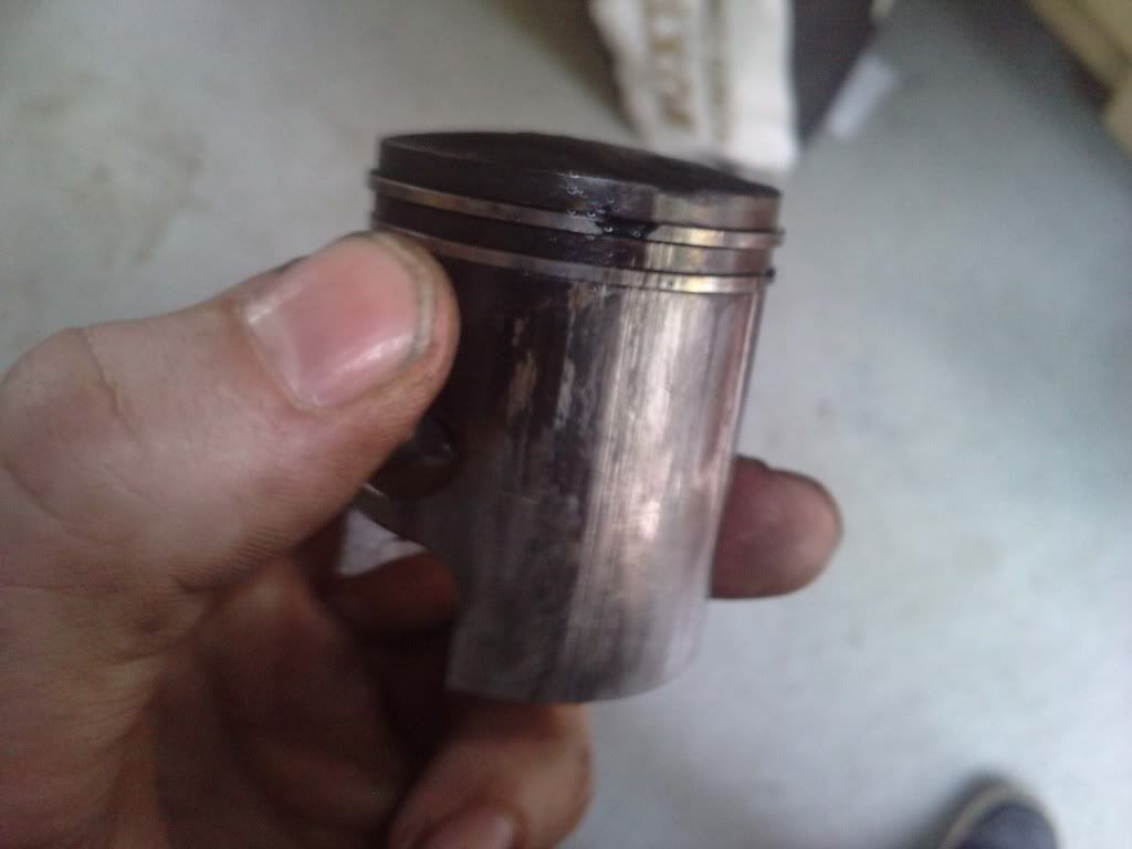

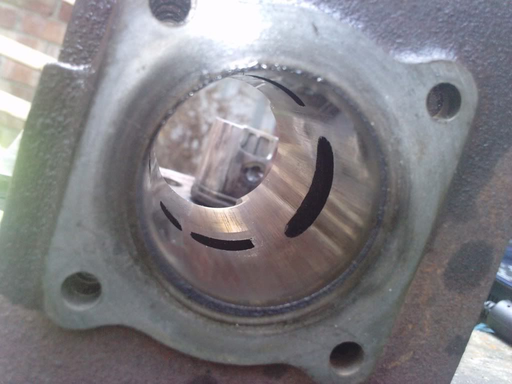

Got the cylinder off, the piston has started to melt and turned an interesting colour, and bits of piston are stuck to the bore! Im guessing its not good?!
Bottom end:
what are the chances of the bottom end being salvagable? Ive got the piston off the rod, all looks well inside. Theres a tiny bit of sideways movement in the big end bearing but no up/down movement. Ive popped some 2t oil into the bottom and been spinning it round by hand to lube it all up.
Il pop a piccy up in a sec Smile

I'd agree that it was not good Thinking
If the problem started with the piston melting I'd say there was a fair chance the bottom end is salvageable

? looks like you might be able to salvage that? hopefully? possibly? maybe?
A tiny bit of sideways play need not be a problem.
Hold the crank still and see if the con-rod can be moved up and down whilst the crank is held tight........ if it moves then you could have bottom end problems Sad .

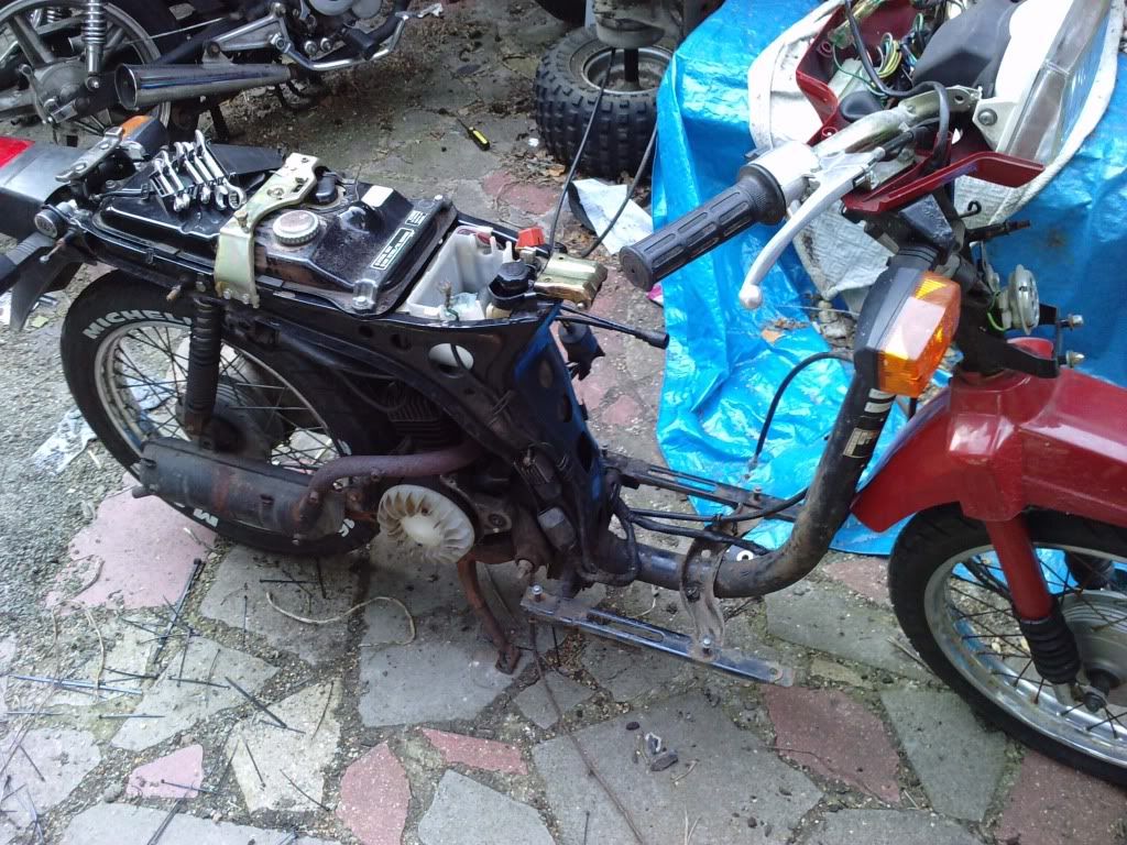

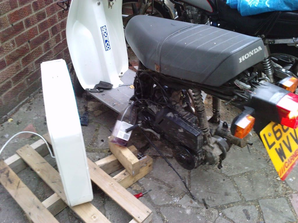

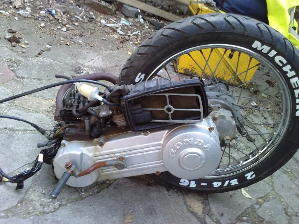

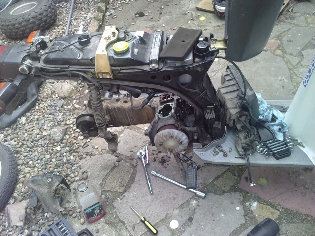

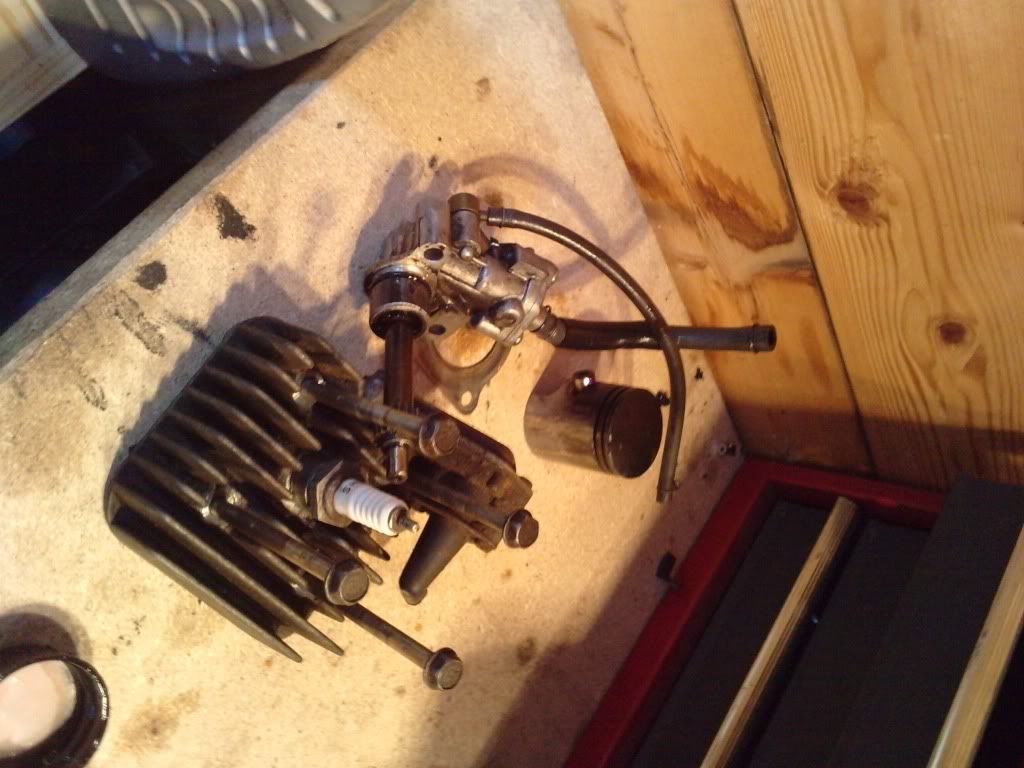

Some photos for ya:
The doner bike
https://i279.photobucket.com/albums/kk125/MartayP/P030811_15030001.jpg
Engine removed
https://i279.photobucket.com/albums/kk125/MartayP/P030811_15070001.jpg
Offending parts
https://i279.photobucket.com/albums/kk125/MartayP/P030811_16130002.jpg
The 'pump priming' setup
https://i279.photobucket.com/albums/kk125/MartayP/P030811_17230001.jpg
Bottle to catch the 2t oil, on the left a big fan keeping the engine cool as the casings arent on to direct the airflow from the fan on the flywheel Laughing

Most stroker oil pumps have a priming screw on the pump body. You remove the screw until oil comes out then re-fit it.
Oil pumps are by their very nature reliable, they are full of oil after all (or should be).
