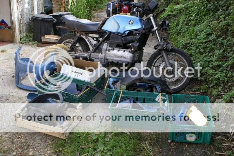

So, Saturday morning me and my stepdad load up the trailer, and head off from rainy Plymouth northwards, the 200 miles to Warwick!
Almost 4 hours later we rock up, and i enter the sellers garden, to find that the auction pictures had been kind. Very kind.
I was expecting the bike to have the fairing removed, however what i found was a bike badly in need of serious medical attention.
I quickly make the decision that as we've come all this way, and it looks at least salvageable I'll take it anyway.
So, we load up the bike, and head back. The sun shines all the way home - is this a sign?
Returning to Plymouth in the dark, we unload the bike into my garage, and slide the boxes in around it. I crash out.
This morning reveals what is to come:
https://i6.photobucket.com/albums/y204/ToGGoT/K100/Arrival2.jpg
I didnt know you could buy flat pack motorbikes...

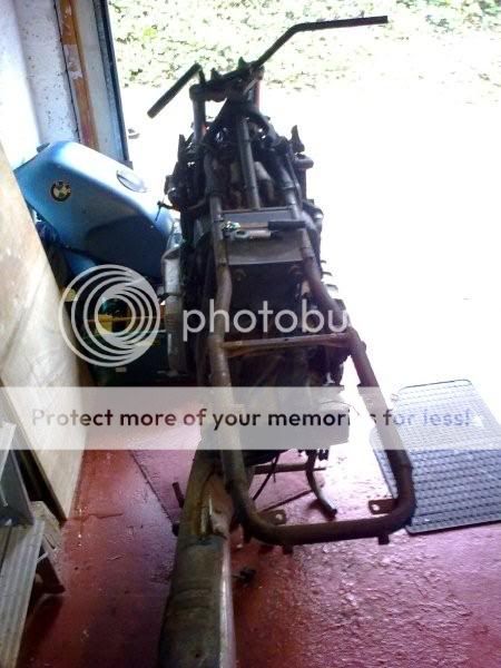

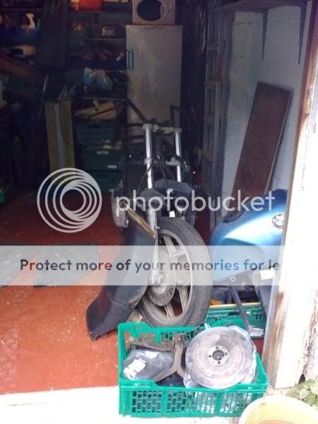

The frame is not in a good state. I think its just surface rust though.
https://i6.photobucket.com/albums/y204/ToGGoT/K100/Arrival10.jpg

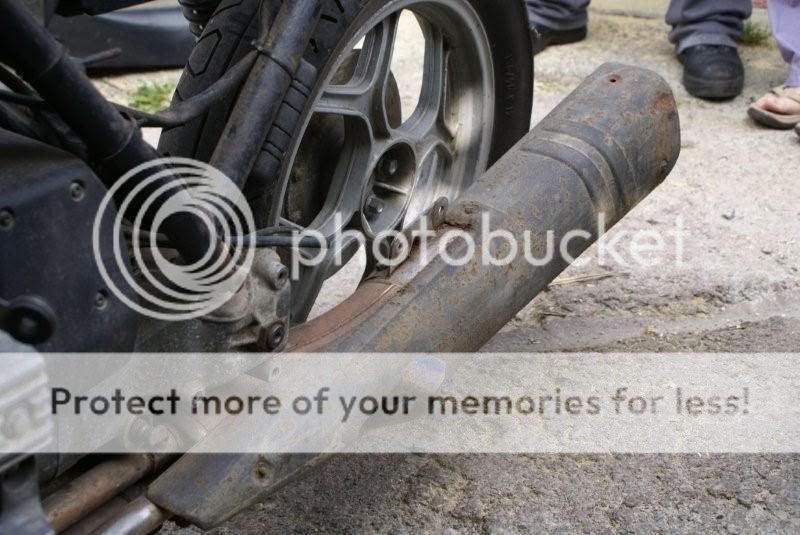

Its been sat for a while. The tyres are gone, and flat, the exhaust is corroded.

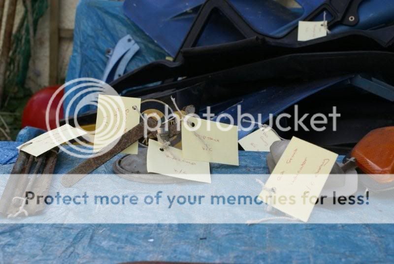

The missus set to labelling everything!
https://i6.photobucket.com/albums/y204/ToGGoT/K100/Arrival12.jpg

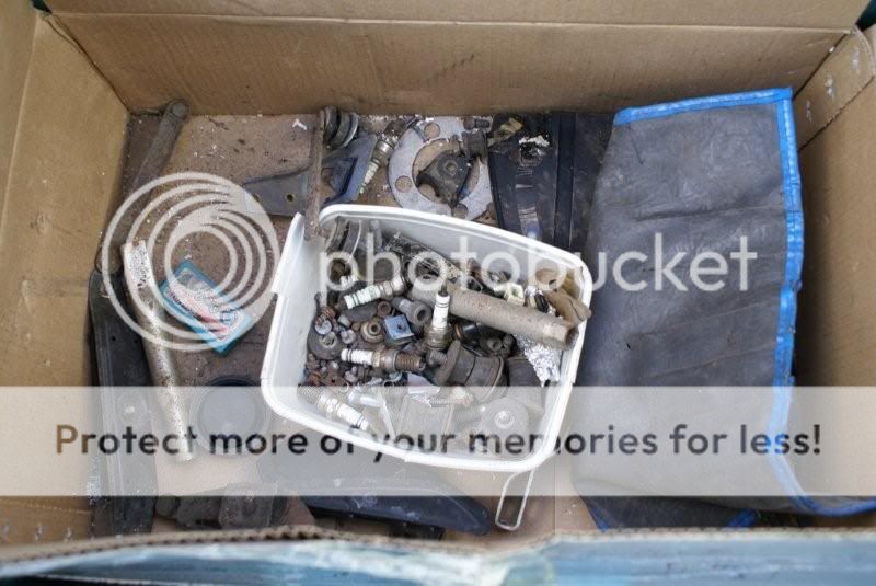

The "Spares".

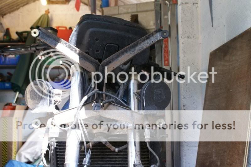

Cover missing, along with one injector... Think its in the spares box.
https://i6.photobucket.com/albums/y204/ToGGoT/K100/Arrival8.jpg
Looks suspiciously like Frenzy from transformers...

Sooo, spent today working away. Still cant get the bloody exhaust off. Two of the nuts are round, and seized solid on the most awkward to get to of the down pipes.

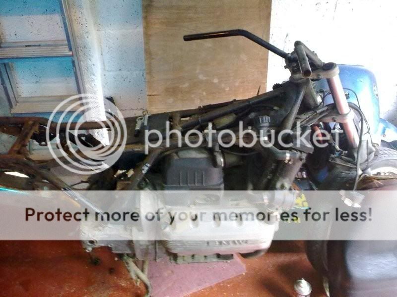

https://i6.photobucket.com/albums/y204/ToGGoT/K100/StrippedBars.jpg

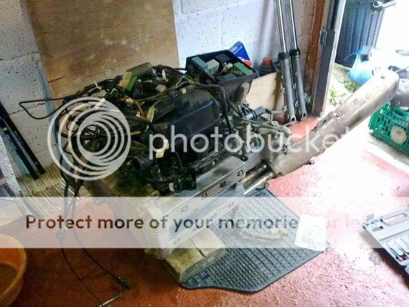

Then pulled off the rear wheel, final drive, and had the shaft out, with help from Mr.Crowbar.
https://i6.photobucket.com/albums/y204/ToGGoT/K100/NoShaft.jpg
Looking sparse without all that extra weight!
https://i6.photobucket.com/albums/y204/ToGGoT/K100/Detail.jpg
Then, realised that the next step was probably engine out. It looked more difficult to drop the engine down than i could be bothered with, so i pulled the radiator and forks off, and lifted the frame off the top!lol!
https://i6.photobucket.com/albums/y204/ToGGoT/K100/FrameGone.jpg

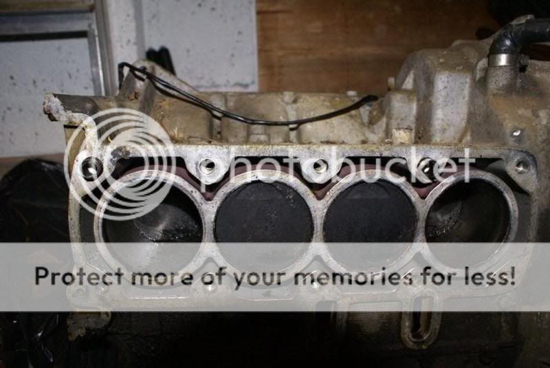

Basically, the bottom end is seized. I've got it in bits, the head looks okish - really needs a clean down the ports. Will strip the valves out tonight.
Am soaking the pistons in the block in a layer of WD40, and have been suggested to do this again with diesel once its evaporated. The crank end bolt is only there to hold the rotor on, so im not happy about cranking it with a torque wrench, so freeing it up might take a while.
Otherwise, the strip down in pretty much there. Now to start cleaning, paint off and all that.

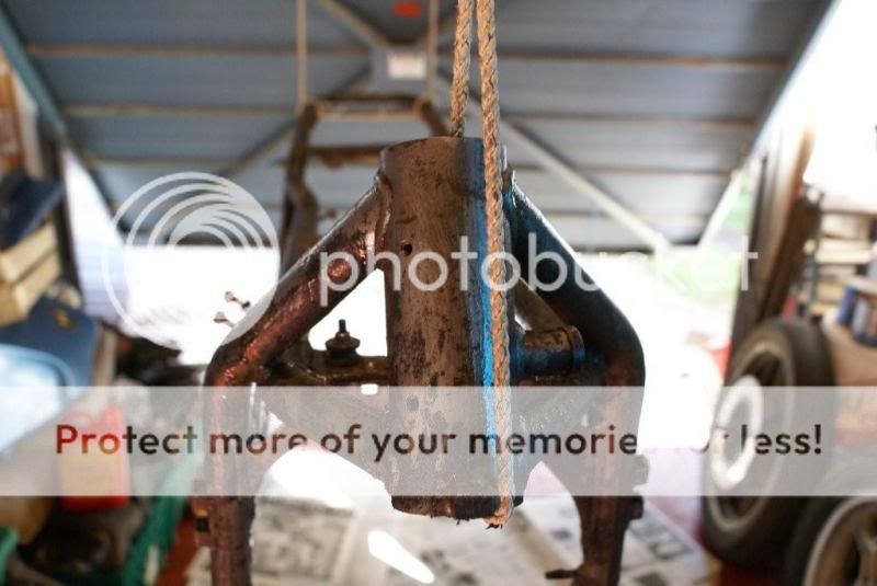

Stripped the frame with Nitro-mors. Good stuff that. Burns you skin though. More rust under the paint in a fair few places, but nothing structural, so will repaint that, and thats good and done.
Soaked the cylinders and pistons in WD40, and have been tapping them with a block of wood and a soft faced hammer. It seems to have done the trick though, as the engine is now free, and turning nicely.
The clutch is FUBAR though. Literally had to destroy the cover plate to get it off, the friction plate has stuck fast, and is shagged, the spring bit doesnt, and im not certain about the back bit either. Thankfully i think Motorworks have got some second hand ones going fairly cheap so i'll chuck one of those in for the time being. The effort of getting it off has close to killed me though.
The auxillary shaft has taken a liking to the thread of the bolt that holds the alternator drive gear too. Heads come right off. Not sure how i'm getting that out, but i'm buggered if i'm buying another drive gear!

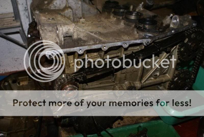

Stripping the covers off.

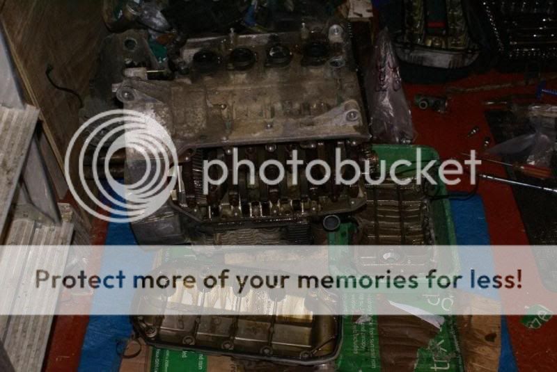

https://i6.photobucket.com/albums/y204/ToGGoT/K100/EngineBreakdown2.jpg
Then cam chain and cams come out.
https://i6.photobucket.com/albums/y204/ToGGoT/K100/EngineBreakdown3.jpg

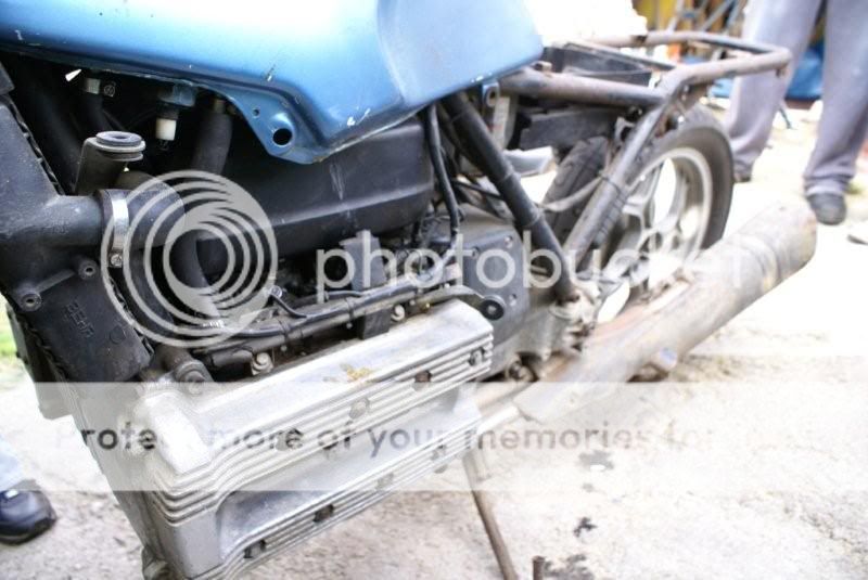

https://i6.photobucket.com/albums/y204/ToGGoT/K100/EngineBreakdown10.jpg
And with the head off...
https://i6.photobucket.com/albums/y204/ToGGoT/K100/EngineBreakdown6.jpg

Frame ready to striphttps://i6.photobucket.com/albums/y204/ToGGoT/K100/ReadytoStrip.jpg
And the Nitro-mors doing its job.
https://i6.photobucket.com/albums/y204/ToGGoT/K100/Stripper.jpg

Hmm, after looking at the picture with the head off I can't help but notice that both of those middle pistons are at top dead centre. Is this a typical firing sequence for an in-line 4 and what is most common for these types of engines?

ToGGoT
Joined: 25 Jan 2009
PostPosted: 16:22 - 11 Oct 2009    Post subject: Reply with quote
Thanks guys.
Im torn 50/50 as to whether to powercoat it or not. On one hand i know a company fairly close that will do it, and sandblast it for me as well. On the other hand, a mate of mine recently stripped his frame, and repainted it with POR-15 rustproof, and Blackcote as a top coat.
If i did that i could do the forks, brakes, bars, headstock, as well as the engine and gearbox in the same gloss colour...
It does look very good, and according to the website its pretty good stuff. Either way it will be black!hehe!
The engine is a BMW Horizontal 4 design. Its actually based on a peugeot 104 engine way back, so its bombproof, but heavy and not that powerful.
Most 4-cylinder engines fire 1,3,4,2. This one is no exception to that!
Just getting together a shopping list to put in tomorrow. Think i'm going to opt for progressive fork springs because i dont doubt these ones are a bit tired.
Sidenote. BMW Parts are bloody expensive!lol!
