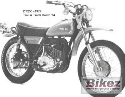

1973 Yamaha DT250
https://classic-motorbikes.net/images/gallery/1973-dt250.jpg
1974 Yamaha DT250
https://www.bikez.com/pictures/yamaha/1974/9570_0_1_2_dt%20250_Submitted%20by%20anonymous%20user..jpg

Well, cant be a 77 DT250, becouse its a twin-shock, nor 75 or 76 model, becouse it doesn't have radial finned heads.... but COULD be 73 or 74 model.... in fact looks remarkeably similar, apart from side panels....
Is it a stripped down DT250?
There is a googlie; Septics on Yam-Forum & classic Dirt Wheels bulatin boards talk of a Yamaha 'MX' model; aprently NOT a full competition bike, like a YZ motocross machine, or IT Enduro bike; but stripped down, LIKE a Scrambler, without lights or equipment sold as a 'Farm' bike.... and descriptions offered, suggest it was basically a DT, without equipment, given some YZ panels.....
Without lights, I dont think its an IT, and twin shock, I think its too early anyway. I dont think its a YZ, it just doesn't look 'right', BUT we;re talking forty year old dirt donk; heaven knows how original it might be. Possibly stripped down DT, or possibly American 'MX' Farm bike, or home brew concoction of models, and after market plastic.
Those side panels are intreguing; up until 1974, the YZ's had triangular plates, often removed and replaced with oval race places, or having oval race plates rivoted over them.
In short very hard to tell from one blurry photo..... so really cant say, be interesting to find out more.
One thing is for sure; probably as many early Yam dirt wheels have entered this country THIS century imported from the USA as barn finds, than were ever imported 'new' in the 1970's.......
It is VERY likely to be a US model import.
And will be a frame and engine number listing job to nail down the major ingredients.
