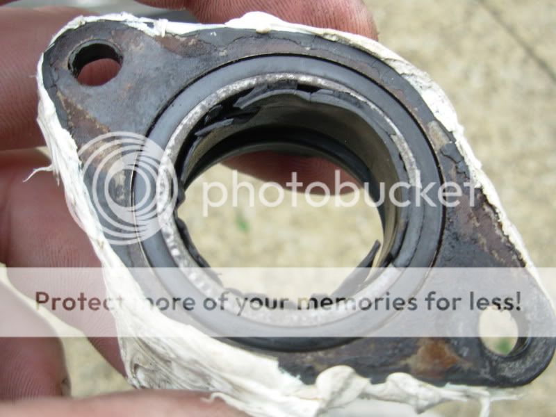

Cheers gents, I knew they'd be stuff I forgot to mention. The air filter element was replaced about 3 months ago with a new item genuine Suzuki). The carb to head inlet rubber was replaced about 5 months ago, it did have an airleak. I thought it would have solved the problem only to find the diaphragm was holed as well, both have been fixed now & the problems continue. Rolling Eyes
This was the old inlet rubber~ the white cack was some sealant I used as a stop gap as there was a big crack on it;
https://i16.photobucket.com/albums/b29/dungbug/DSCN5488.jpg
The inner part was also perished (not overly clear in the photo);
https://i16.photobucket.com/albums/b29/dungbug/DSCN5486.jpg

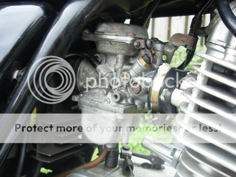

Fitted back on the bike;
https://i16.photobucket.com/albums/b29/dungbug/DSCN5490.jpg
