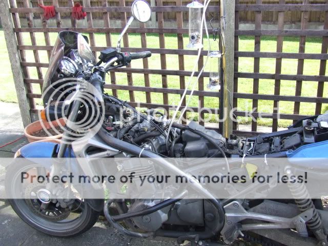

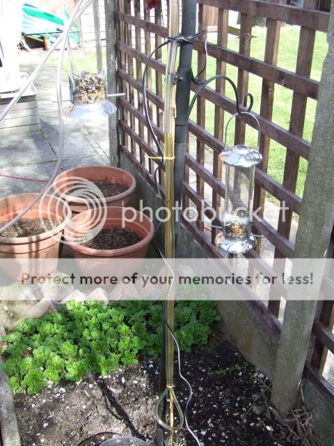

Running beautifully now. Less vibey, more low down grunt.
https://i15.photobucket.com/albums/a376/ms51ves3/DSCF3308.jpg
https://i15.photobucket.com/albums/a376/ms51ves3/DSCF3310.jpg

i'm at a loss of how this has been set up.
Am I right in saying its a continous piece of tubing with parts of it fill with oil and the ends attached to the vacumm nipples?

Yes.

Didn't have any, and this was an old bottle of 2 stroke oil that's never going to get used. Yes it is 2 stroke oil, even though it's golden and not red/blue/green.

No pinches Thumbs Up Just the tube in a 'U' is all I used.

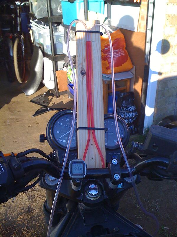

Finally Smile
https://www.bikechatforums.com/files/manometer2.jpg
For next time :-
1. Use a longer bit of wood.
2. Or less fluid.
3. Put it on the floor, not on the bike. Otherwise when you overadjust, the fluid goes over the top bend and heads to your carb. Meaning you kill the engine, and have to wait to get the fluid back in the loop again. Meaning the carbs will run out of fuel restarting it. Again.
