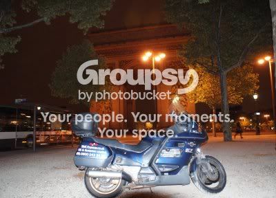

If not and you still want one, I'm looking to shift this one.
Needs some work doing but T&T and can be used as is
https://i370.photobucket.com/albums/oo141/bramble43/triumphe400.jpg
