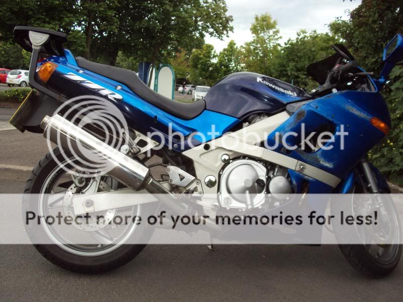

I am speaking from experience and 2 years of hunting:
https://i14.photobucket.com/albums/a324/david_m213/DSC00459.jpg?t=1317853796
you'd probably be best getting your own plastics repaired & resprayed. To be honest though, you'd be much better putting your money into upgrading the brakes and suspension.
I also disagree with the "higher insurance premiums" thing too. I'm 21 and pay £150 tpft per year, 4 years NCD.
