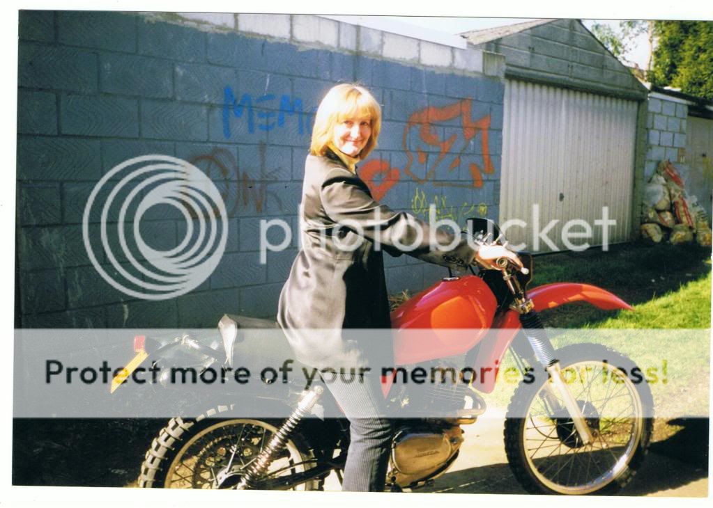

https://i666.photobucket.com/albums/vv23/WiNot_Rhencullen/Dirt%20bikes/BikesBikesBikes311.jpg
Mrs.Fizzer tries the bike for size
