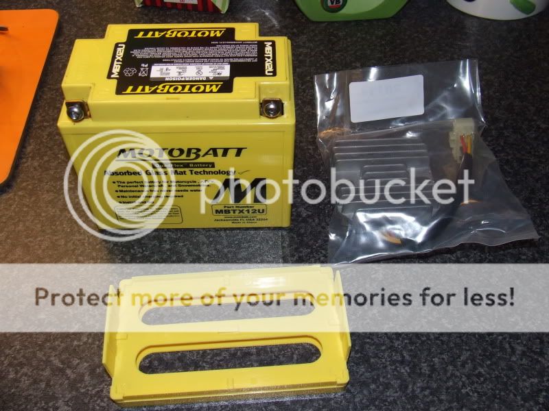

Ordered the reg/rec yesterday dinner and it arrived this morning via special delivery. My new AGM battery that I ordered on Sunday also arrived.
£130 Crying or Very sad :
https://i15.photobucket.com/albums/a376/ms51ves3/DSCF3238.jpg
All fitted and working perfectly now. 14.3v with the lights off, 14.25v with the lights on, and 14.2v with the lights and heated grips on.
And I never did have to get the bus Dance!
