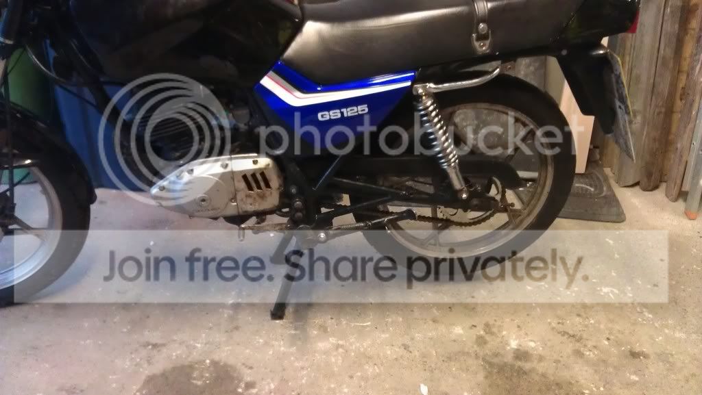

First up... the old.

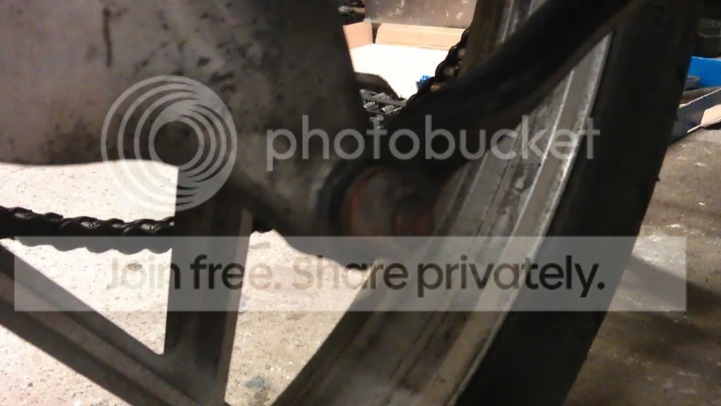

This chain was well past it.....
https://i19.photobucket.com/albums/b181/r05_ltd/IMAG0172.jpg
That is a gap between the chain and sprocket.

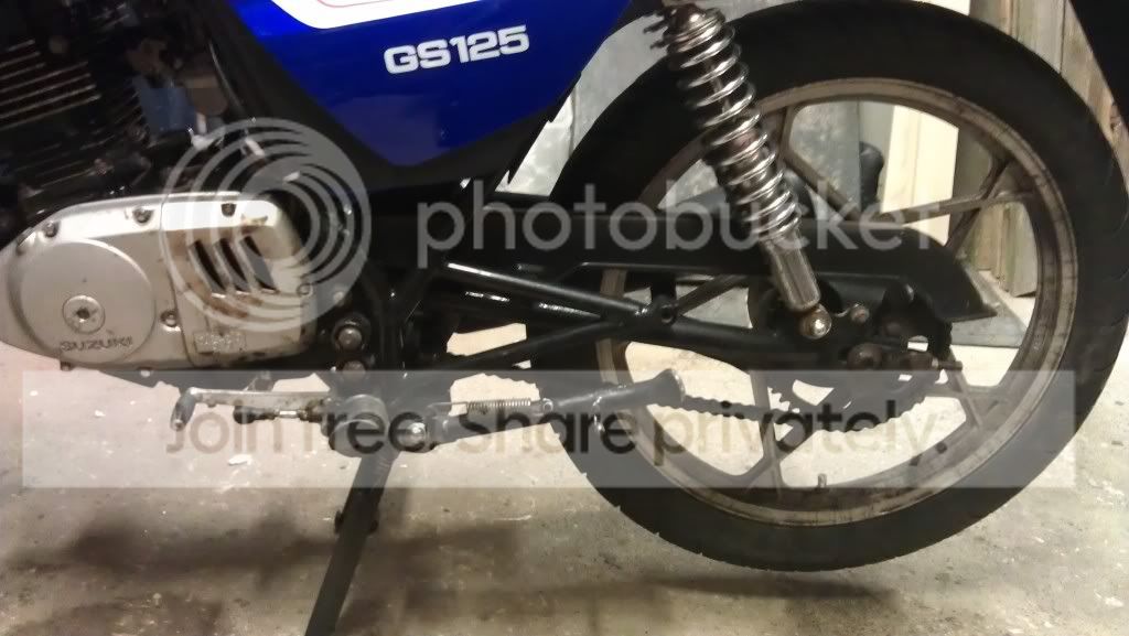

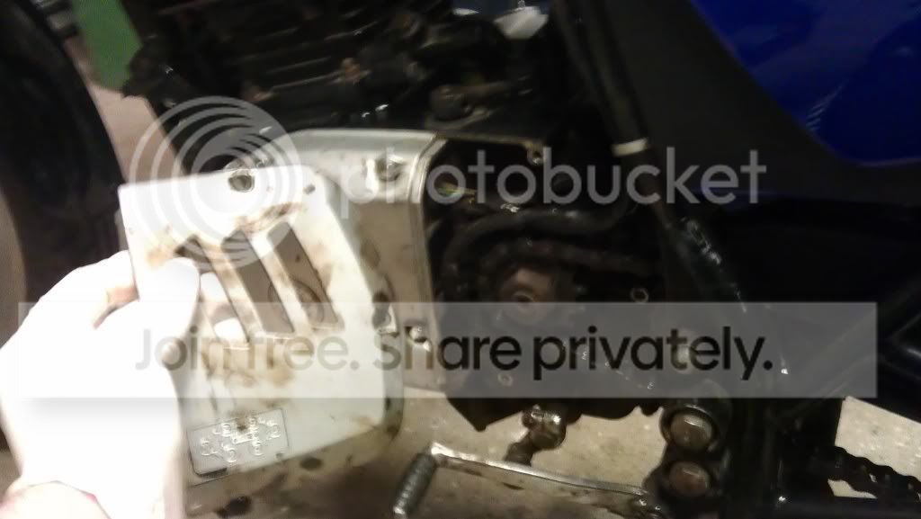

next... remove the front sprocket cover...
https://i19.photobucket.com/albums/b181/r05_ltd/IMAG0175.jpg

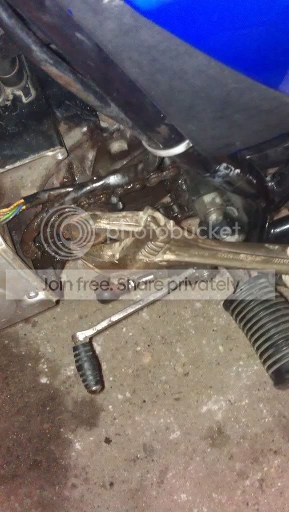

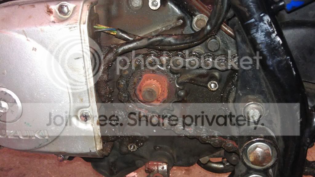

Sit on the bike with your foot down on the rear brake (or get someone else too) and undo the front nut (be carefull!)
https://i19.photobucket.com/albums/b181/r05_ltd/IMAG0177.jpg

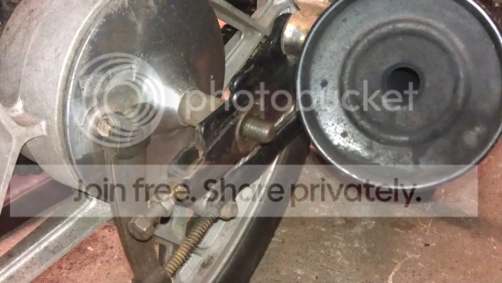

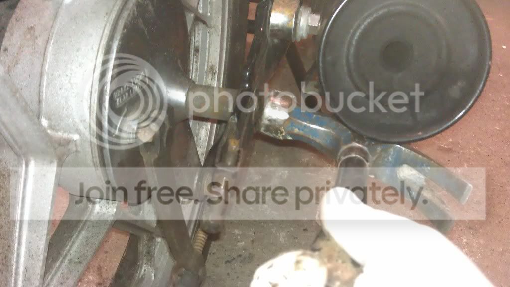

Then undo the spindle nuts and the pully things that pull the wheel to tension the chain...
https://i19.photobucket.com/albums/b181/r05_ltd/IMAG0179.jpg

Push the wheel as far forward as it will go, then Remove the Front sprocket...
https://i19.photobucket.com/albums/b181/r05_ltd/IMAG0178.jpg

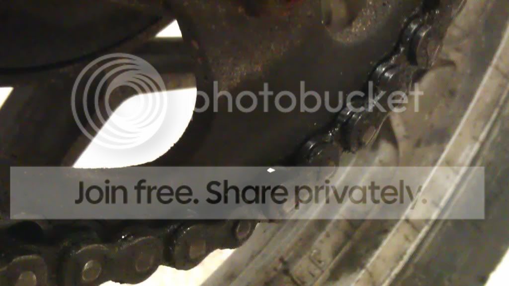

The wheel should now be free. Take the chain off the rear sprocket, and take it off completely.

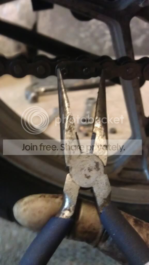

To remove the Chain, just cut it off with a grinder, or, undo the split like (push the open end with some needle nose plyers, then it will come apart)

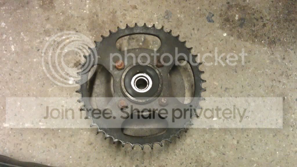

Right, all removed. Now my sprocket came off on the hub like so...
https://i19.photobucket.com/albums/b181/r05_ltd/IMAG0187.jpg
Use a little WD40 on the nuts, give it 5 and crack off, i used a vice to hold the sprocket while undoing the nuts, just make sure there are no open draws below that the bolt can fall into and spend 20 minutes looking for Laughing

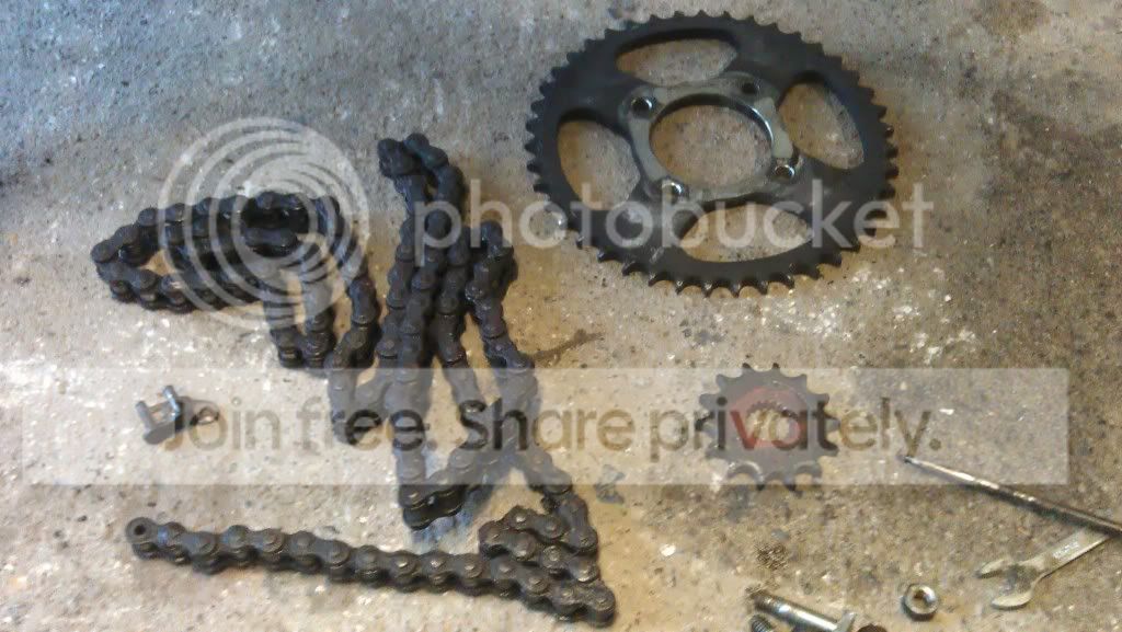

you should now be left with these, the old components...
