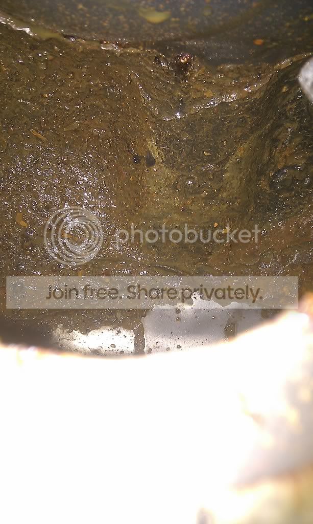

PostPosted: 20:49 - 10 Jan 2012    Post subject: Reply with quote
Fork seals may have gone hard and leak, as mine have.
If its a metal tank, then that can rust, as mine has.
https://i1126.photobucket.com/albums/l618/HDrayton7/Suzuki%20Bandit%20400%20Project/IMAG0522.jpg
