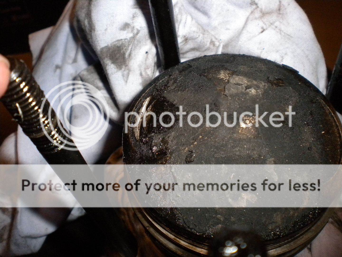

I decided enough is enough and pulled the head off. It was immediately apparent from the mark on the piston crown that it's dinged the exhaust valve at some point so I'm calling the piston scrap and the valve bent even if they're not. Bore looks, feels and measures up as fine though.
Oops!
https://i48.photobucket.com/albums/f216/stinkwheel/enfield%20head%20231010/dscn1421.jpg
Whoopsie!
https://i48.photobucket.com/albums/f216/stinkwheel/enfield%20head%20231010/dscn1423.jpg

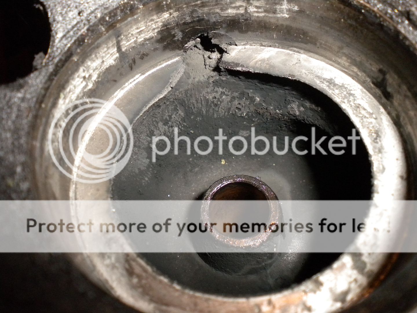

I just took the valves out and I think I have a more fundamental problem. As I wiped a finger round the exhaust valve seat, it dropped out and is totally loose in the head, it can be pushed in and out with light finger pressure. There is no apparent visual damage to the seat itself but the alloy under it looks none too clever.
Some images.
Valve seat in place:https://i48.photobucket.com/albums/f216/stinkwheel/enfield%20head%20231010/dscn1424.jpg
Valve seat removed: https://i48.photobucket.com/albums/f216/stinkwheel/enfield%20head%20231010/dscn1425.jpg
Extreme close-up of head under valve seat: https://i48.photobucket.com/albums/f216/stinkwheel/enfield%20head%20231010/dscn1428.jpg
So. Scrap and new head? Or ream out and fit bigger valve seat (if I can find one that suits).
I'm at pains to point out that the loss of compression and popping was already happening BEFORE I drag raced it.

On a closer look. Does it look to anyone else like a circular defect/drilling has been filled in with a plug or weld that has partially melted?
I wonder if it was like this from new (or somewhat like this then exascerbated by the hot gasses).
temeluchus
Joined: 01 Oct 2008
PostPosted: 03:08 - 12 Jan 2012    Post subject: Reply with quote
Looks like a repair if a faulty casting repair that's given out.
Poke at it a bit, see if there is a larger cavity behind there!

Id say that looks like poor casting thats been repaired. Send them pics, you may get lucky??

That does look suspiciously round.

Also it looks like the piston has slightly melted in that pic, around the 4 Oclock position ? or it could just be the pic making it look like that, It all seems pretty oily in there tho.
It almost looks like the head has a drilling that has gone too far and been poorly welded back up which is a bit poor really considering where it is Shocked .
scrap I would say unless you can find a bigger seat (and maybe valve too) and someone good enough to repair the head and fit the seat.

New head. Even if you fixed that one up (costing most of the £300 for a new one) you would never trust it. Every little problem with the bike would have you suspecting the head as the cause.

Looking at those heads, and Stinkwheels earlier pics, it looks like they were set up for twin plugs. Is this common on them.

royal oilfield ( cruel i know as usually oiltight ) you drag raced it you naughty boy ( valve bounce bent push rod?? )
However, lookin at pics the hole does seem round!! the blow hole i mean.
head scrap, is small round thing opposite plug a decompressor?

Bloody hell have you ordered a new head? I would fix that sooner than pay £350. I'd weld it up, indicate off the guide and bore a new pocket with a 2 thou interference for the seat.

By the way there's nowt wrong with the piston I'd say, but if it's a shell-bearing crank you better pop off the big end and see if there's any damage from pounding on the crooked valve seat.

That does look like a faulty casting that has been drilled, welded and re-profiled prior to having a seat fitted. If the seat had been a tight fit it would probably never have been noticed as combustion spreading the seat would have sealed it just as it seals the valve in position.
It is repairable and I would have thought it was doable for less than £100. I know the company that does diesel head repairs for Citroen and Peugeot and have seen a lot worse than that repaired like a crack between the inlet and exhaust valve machined out, filled with weld and machined back to shape ready for a new seat to be fitted.
The chap that does the work is an old Irish man but sadly he has no beard, can PM you his details if you want them?
Wotcha.
It's a "floating bush" big end - one piece con-rod.
