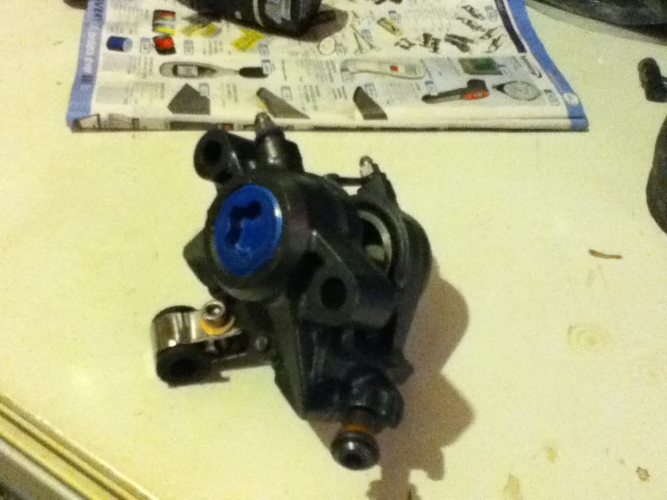

R6 Front Brakes
SRad Tail reworked and bolted to existing frame
Shocker was eventually mated from a Triumph TT (same eye to eye) Installed upside down.
Renthals
Stubbied pipe
Aprillia 125 front mudguard Still to paint and tank.
https://i284.photobucket.com/albums/ll9/manxhornet/Ipod003.jpg
https://i284.photobucket.com/albums/ll9/manxhornet/Hornet001.jpg
Madmanx
Joined: 22 Dec 2007
PostPosted: 10:56 - 21 Jan 2012    Post subject: Reply with quote
I found the brakes hard to bleed but I found bleeding it from the master cylinder did it quickly.
The stock rear shockers are pure shit and make me seasick.
I got the r6 shocker but the housing for the gas was fouling with the mounts.
The Triumph TT fits if shimmed out and is an absolute pleasure to ride (especially as I live on the Southern 100 course now) on the TT course(Isle of Man).
The brakes are a straight swap.
I overhauled them in about an hour and sprayed them gunmetal grey using hi temp paint.
