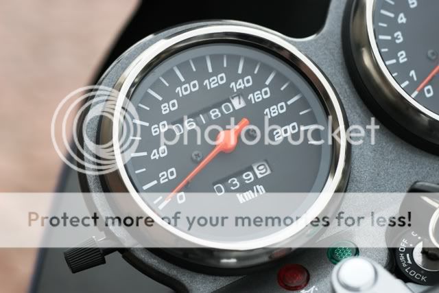

Not bothering to put an alarm on the CBR, I've only got another month and a week or two riding it. Exciting times Laughing
The GS has the "deep" clocks like this:
https://i.ebayimg.com/00/s/NzY0WDEwMjQ=/$(KGrHqYOKkYE6kKgi9stBO)c99QRr!~~60_3.JPG
So I was thinking that opening it up would be an option if I did get that bike?
Though saying that, I just dug up a picture of the dash and there seems to be a great place for the LED above the ignition - so that solves that problem.
https://i8.photobucket.com/albums/a43/alison_75/Dash.jpg

PostPosted: 00:06 - 18 Feb 2012    Post subject: Reply with quote

LOL; LED in the dash? Wot like I did with the Corpral?
Yeah, MORE difficult that it looks! You have to be bludy careful cracking the instruments apart to not damage them! Looks good though.
Quite possibly. I know that I've seen it somewhere before, but I can't for the life of me remember where. Laughing Perhaps you could give me a hand with that then - I could mount the LED with tape or something until I can ride the bike, then bring it over and fit it properly. I tend to get a bit, erm, "destructive" when things don't come apart easily Laughing
