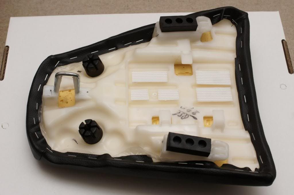

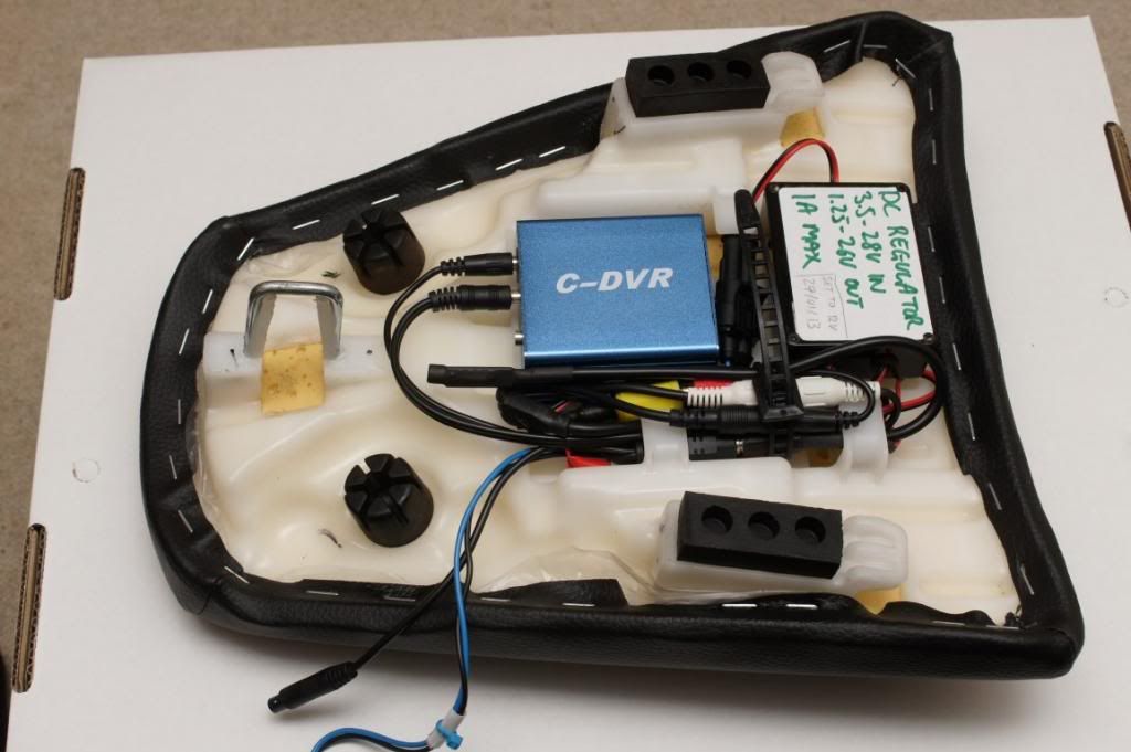

https://i1300.photobucket.com/albums/ag81/Dave_343/DSC00040Medium_zps2ce1159b.jpg?t=1362092775
- I have all of this (bar the cam of course) crammed in the service book compartment under the back seat, held in with cable ties and Velcro. Will update with in-situ pics when I get my bike back.
- The power comes from piggy backing off a sub fuse, doesn't take too much power, far less than the 2A fuse I've got the kit behind.
- The cable the camera came with was far too long so I cut it down and soldered on my own connectors.

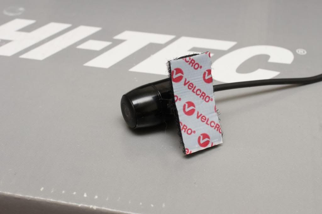

- The mic is tiny and sits right at the end of the cable.
- Everything runs at 12V

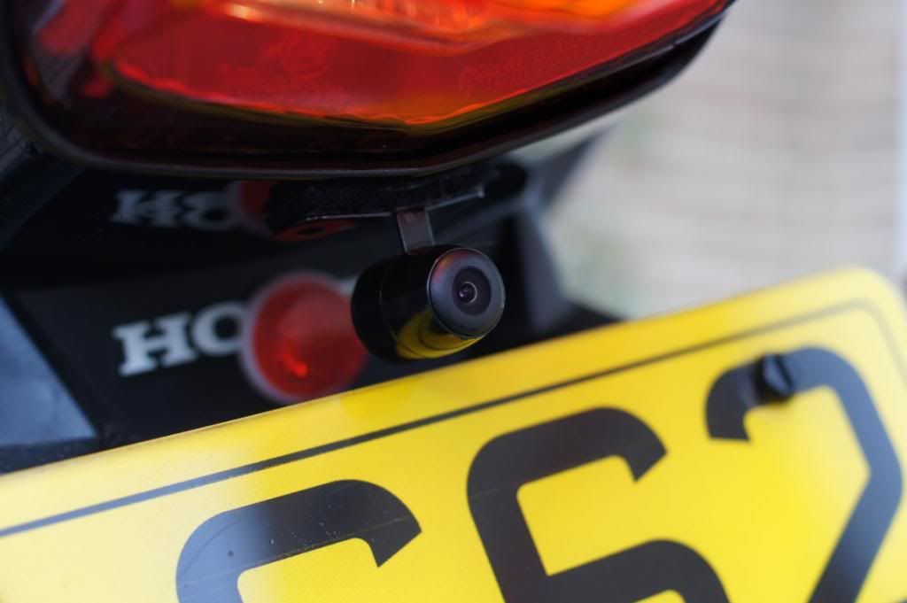

I have the camera stuck 'upside down' under the tail light
https://i1300.photobucket.com/albums/ag81/Dave_343/th_DSC00045Medium_zpsfce03b97.jpg

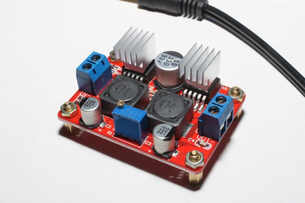

Pic of the voltage regulator like the one in the box, this one has heatsinks but the one I used for this project doesn't.
https://i1300.photobucket.com/albums/ag81/Dave_343/th_DSC00042Medium_zps303816db.jpg

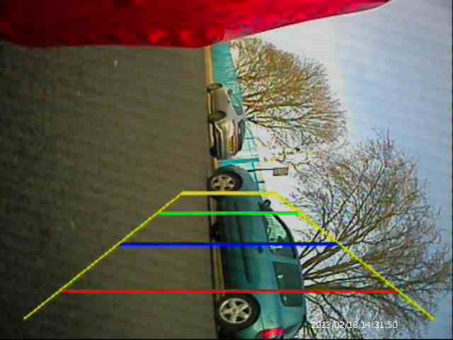

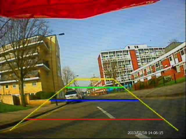

This is the only thing I need to 'fix', the camera I bought is sold as a rear view camera and as such it's mirrored and has distance markers! I'm going to upgrade it with a better cam that doesn't have markers or isn't mirrored soon!
https://i1300.photobucket.com/albums/ag81/Dave_343/th_CAM1_zpsa6bfb945.jpg

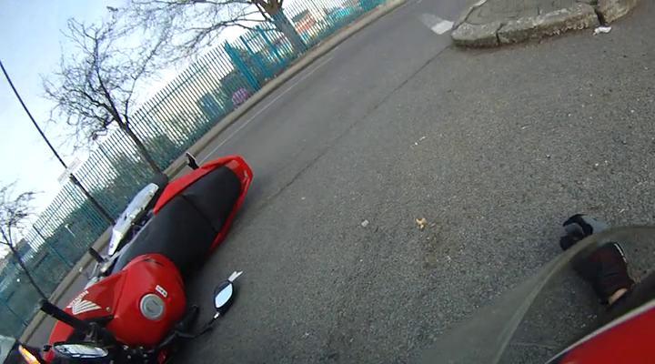

Still image of my latest spill
https://i1300.photobucket.com/albums/ag81/Dave_343/th_CAM2_zpsde073c04.jpg

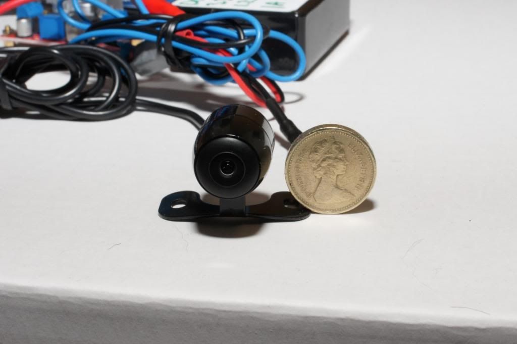

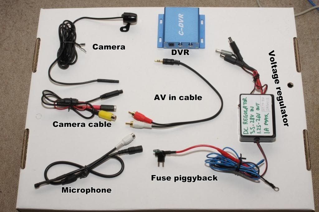

Photo of parts now with annotations!
I forgot to mention, the rear view cam is supplementing my front facing helmet cam, it's a Contour ROAM if you wanna look it up. I'm actually using the Contour's footage for an on-going insurance claim right now.
I'm not going to upload the crash footage, yet, but here's a taster;
https://i1300.photobucket.com/albums/ag81/Dave_343/vlcsnap_zps71cf8bb3.png

The regulator I have is called a DC step up down regulator, there are quite a few on ebay;
https://www.ebay.co.uk/sch/i.html?_nkw=DC+step+up+down
The one I've got and many of the ones listed in the search above require at least a multimeter (or volt meter) to get going, because you need to monitor and adjust the output voltage to 12V. In my example the output voltage is adjusted by turning that tiny little brass screw on the blue component, called a 'trimpot', seen on the middle bottom of the board below.
Or you could get something that only outputs to 12V, but these are a bit more expensive.
https://i1300.photobucket.com/albums/ag81/Dave_343/DSC00042Medium_zps303816db.jpg

I've finally got my bike back from the workshop, it's very shiny, almost every external facing bit of body has been replaced at the third party's insurers expense Very Happy
As promised, the camera in-situ;
First I had to reattach the camera, was held by double sided tape before but now with black Velcro,
https://i1300.photobucket.com/albums/ag81/Dave_343/th_DSC00122_zps05b42a74.jpg

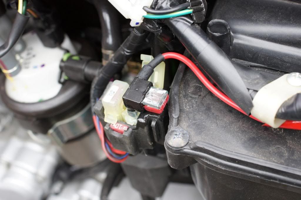

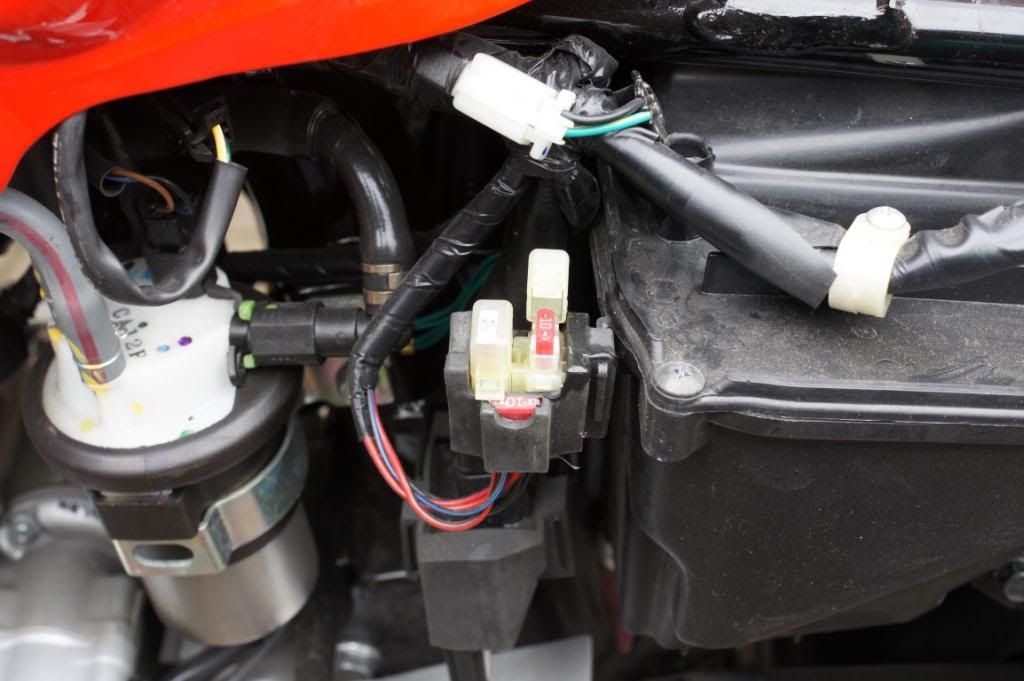

The kit gets its power by piggy backing off a sub circuit fuse. Lots of silicone grease applied to keep the elements out now that the protective cap is off,
https://i1300.photobucket.com/albums/ag81/Dave_343/th_DSC00129_zpsa7121db6.jpg

The camera installed,
https://i1300.photobucket.com/albums/ag81/Dave_343/th_DSC00139_zps9004621f.jpg
Inb4 stupid place for reflector, the dealer stuck it there when I asked for L-plates, got my licence now but it's stuck on there good so left it.

what box did you use for the regulator? i've bought myself the bits and pieces to do this but was a bit surprised when the regulator came just as the bare board!
Past: '07 YBR125, '00 GPZ500S, '99 ZRX1100, '98 CBR600 track bike, '97 ZX9R
Present: '05 R6 track bike, 140 pit bike
Dave_R
Joined: 18 Feb 2013
PostPosted: 18:41 - 28 Mar 2013    Post subject: Reply with quote
I don't know exactly, the one I used was recycled from a previous project I binned. It's a generic plastic enclosure for electronic projects, ebay has plenty (search for 'project enclosure') or pop in to Maplin who should have a decent variety on the shelves.
You may even find one that fits better that the one I have since I grabbed what I had to hand at the time. But remember, when sizing up, don't forget to add about 1cm to the sides of the regulator board where the connectors are, something I often forget!
Or, you could forgo the box and instead wrap the board in electrical tape, you can save a lot of space this way. I'd have done this myself if I hadn't found a box handy.
