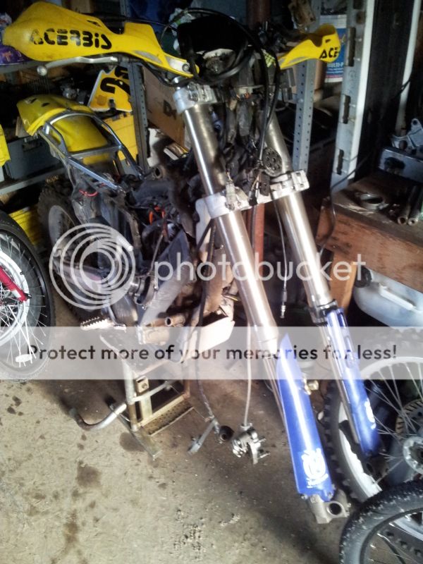

Well my Old Husky TE610e Gave up the Gost a while back (Stator plate no Spark)
The Suspension was "ok" But off road was Rather Soft Sad
It also came with Super Moto wheels Never got around to Riding on them Embarassed
So Now i have Made a start on the "rebuild" Wink Mr. Green
So far the Husky is a 2000 Model and i toke the Plunge into trying to Fit 2005 USD Forks and 2008 Clamps from a SMR570 Wink
And it Paid off Twisted Evil Mr. Green Laughing All Fitted Lovely Shocked Mr. Green
