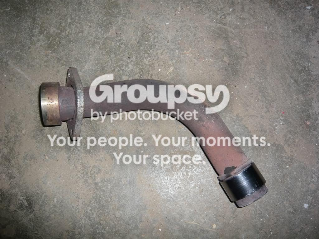

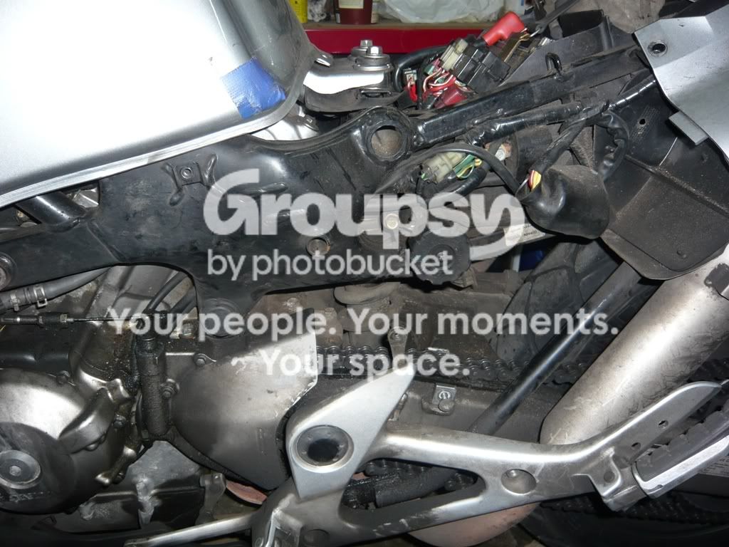

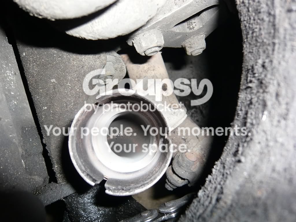

I forgot to mention. The rear header pipe connection with the balance box failed. This is apparently a common problem, just this one particular gasket. The service history showed that this gasket had been replaced before I bought the bike. It failed again this summer.
I was told that the whole exhaust system had to be dismantled to replace this gasket which is hidden deep inside the middle of the bike. Then I heard one bloke had changed his without doing this. I tried his method and managed to remove the rear cylinder down pipe, replace the gasket (a few quid's worth) and replace the pipe without taking any of the rest of the system off. I had to use some pretty weird combinations of sockets and extension pieces and had to remove the plastic chain guard but it was actually possible.

The pipe in question is inside there.
https://i19.photobucket.com/albums/b165/yen_powell/varadero%20tech/P1090243.jpg
This is inside the connecting pipe, the gasket had completely dissolved.
https://i19.photobucket.com/albums/b165/yen_powell/varadero%20tech/P1090244.jpg
The pipe I managed to get out with it's new gasket in place.
https://i19.photobucket.com/albums/b165/yen_powell/varadero%20tech/P1090247.jpg
