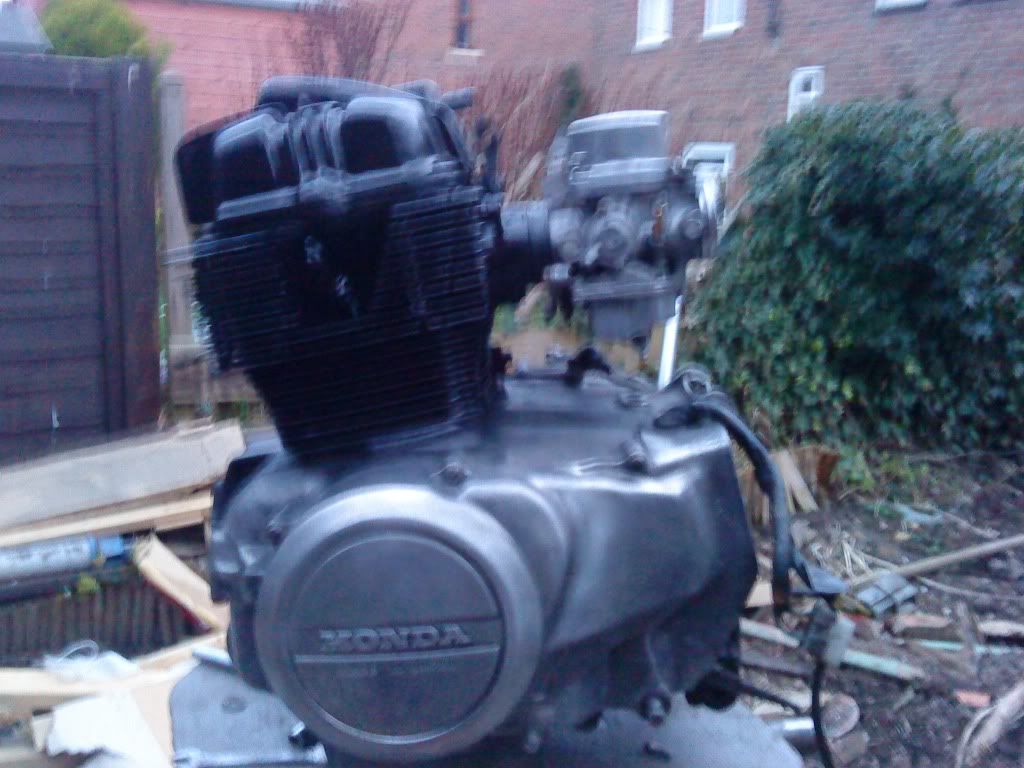

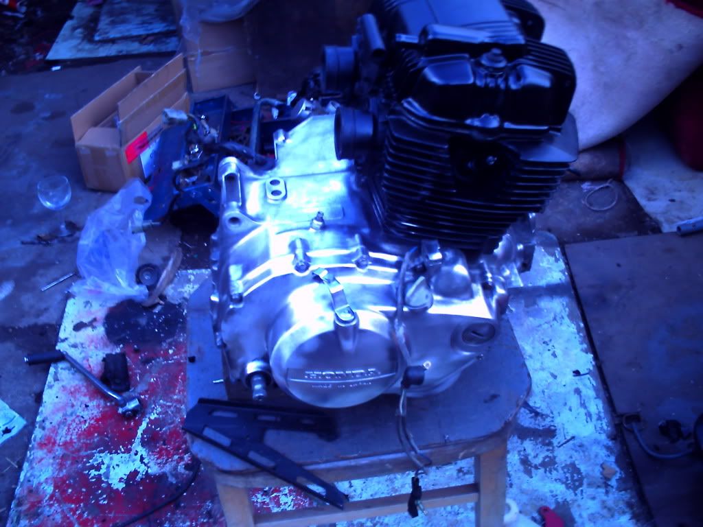

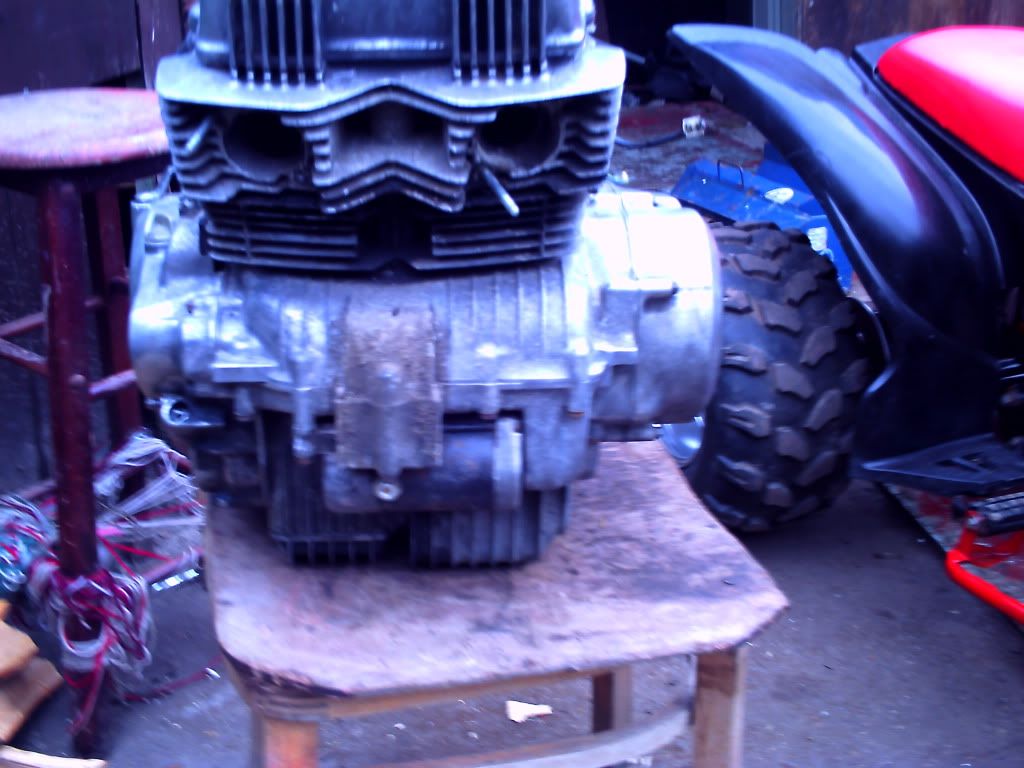

great project, always been a big fan of the early Cb250's polish your engine this is what my engine looked like when i got it
https://i199.photobucket.com/albums/aa288/waynenoonan1234/PICT0038.jpg
after a clean
https://i199.photobucket.com/albums/aa288/waynenoonan1234/DSC00631.jpg
and after a good few hours polishing
https://i199.photobucket.com/albums/aa288/waynenoonan1234/PICT0057.jpg
