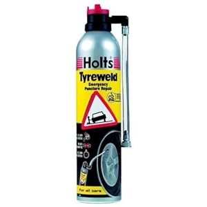

Haven't had personal experience, but my mate swears by this stuff.
https://ecx.images-amazon.com/images/I/41w9zPnVNSL._SL500_AA300_.jpg
https://www.halfords.com/webapp/wcs/stores/servlet/product_storeId_10001_catalogId_10151_productId_164880_langId_-1_categoryId_165664#tab1

Dunno about the tyre weld stuff, probably leaves a right mess in the tyre as well Idea

Tyre weld is the biggest piece of trash available on the market I know its a temp repair but my idea of a temp repair is you get you home so you dont get mugged by the closest bike garage or have to wait the 3 hours for the AA to arrive, not just 300-400 yrds Rolling Eyes
