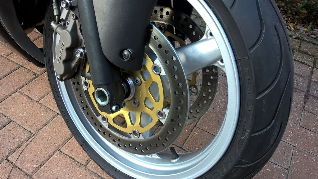

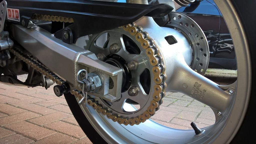

Actually had it a few weeks but it's been in bits since I got it. Back together now so thought I would share a few pics.
https://i1077.photobucket.com/albums/w462/MattB70/ZX6R%20A1P/WP_20151223_11_55_05_Pro_zpsygwrm97x.jpg
https://i1077.photobucket.com/albums/w462/MattB70/ZX6R%20A1P/WP_20151223_11_53_29_Pro_zps7lnheell.jpg
It was in bits because I've just replaced the fork seals (heavier 15w oil and a reduced air gap), put a part worn tyre on the front, new SBS Sintered pads (old ones were contaminated by leaking fork oil) and a chain & sprocket kit.

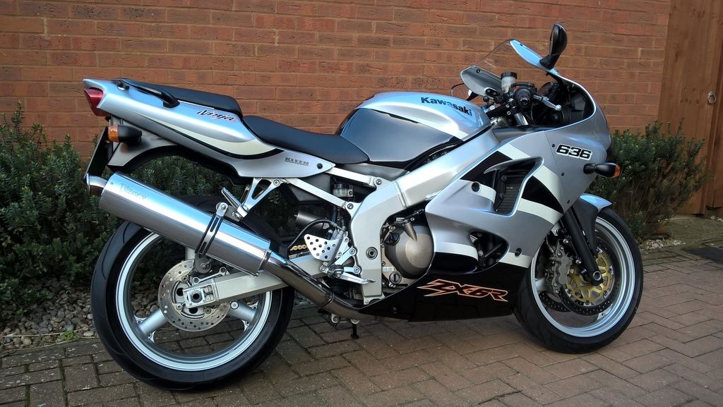

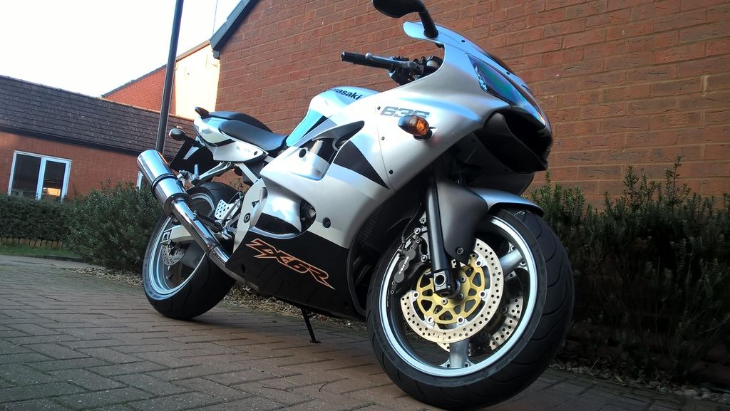

https://i1077.photobucket.com/albums/w462/MattB70/ZX6R%20A1P/WP_20151223_11_57_18_Pro_zps3kobxjgj.jpg
https://i1077.photobucket.com/albums/w462/MattB70/ZX6R%20A1P/WP_20151223_11_58_21_Pro_zpsywzzifmd.jpg
I wanted something for the Winter that had a fairing for protection from the elements (so not the Bandit) and that wouldn't spin up the back wheel and spit me down the road in the wet (so not the ZX12).
These A1Ps were the last model before the ZX6R got all small and cramped, they are a bit more roomy and comfortable. It's done a bit over 12k miles and rides really nicely, seems really small and light compared to the other two bikes.

I always turn those funky R-pin efforts through 45 degrees on my kwakka so that they're around the castleated doobrey. Not sure if I'm doing right mind.

The R clips I always leave like that. You can turn them flush with the swingarm but it stretches the clip and opens it up a bit. Haven't ever had an issue with them catching anything.
