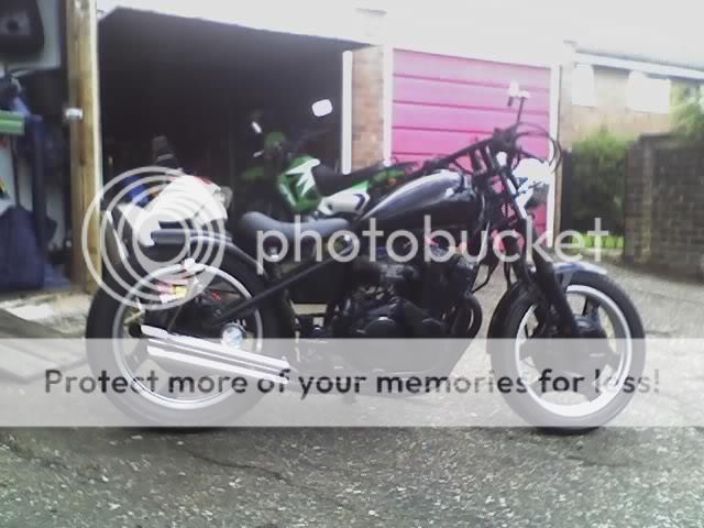

Not bad bikes at all. My mate had one and turned it into this hardtail show winner...
https://i35.photobucket.com/albums/d199/sim0nc0/19-07-08_1249.jpg
...for a total cost, including the bike, mot and tax, of £117!
