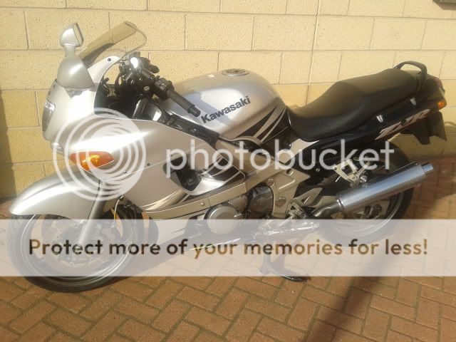

Got a ZZR about two weeks ago after a year on a CB500 and I'm buzzing my tits off on every ride Laughing
The brakes do work okay but you need to apply a good amount of force to get them to bite. I've ordered some CBR600RR calipers which are supposedly an easy swap.
Next payday I'll be buying a Hagon shock too as the stock one is no good for pillions as the added weight makes the centre stand bottom out when leant over.
I also think they look awesome in an old school sort of way!
https://i1323.photobucket.com/albums/u587/mjs1066/20130701_073710_zps5d70ef9b.jpg
£12.50 on eBay buys you proper conversion bolts and spacers (do NOT use sleeved bolts and washers for your brakes!)
Sometimes you need to file the inside of the body a little bit too to clear the disc. Depending on the year / shape of caliper you might need to trim your mudguard.
Also, bollocks to the Hagon - ZZR 1200 shock is the way forward.
