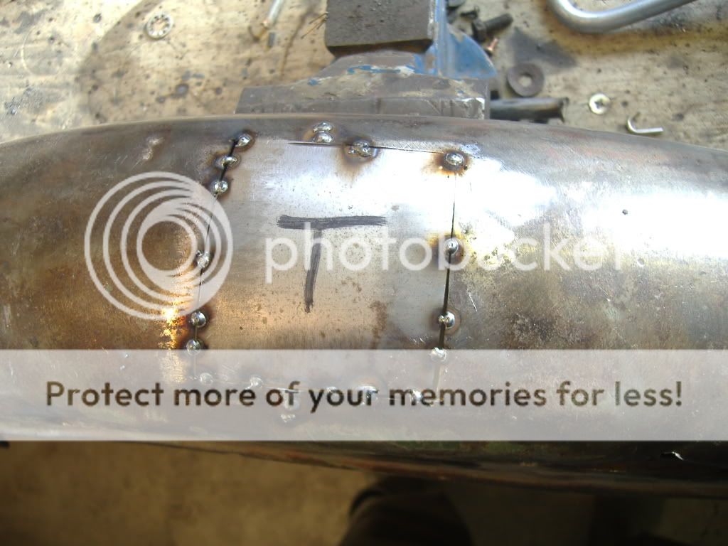

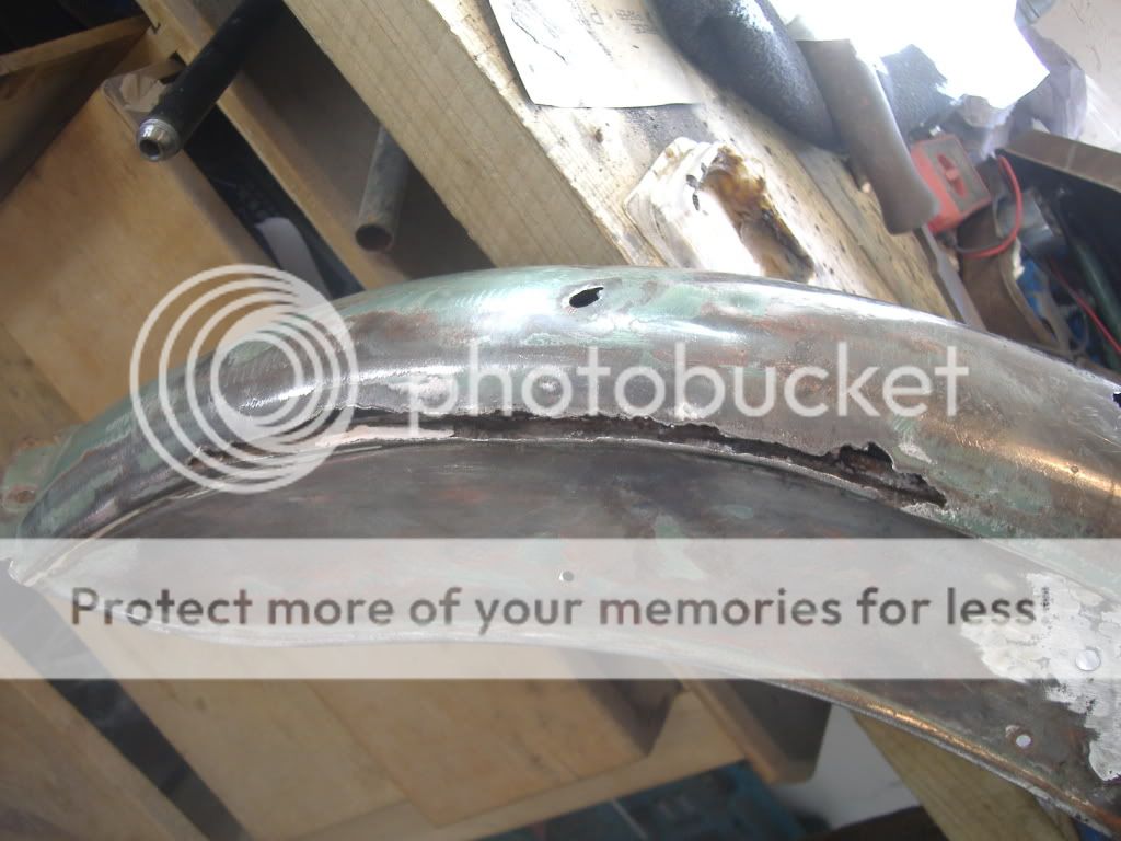

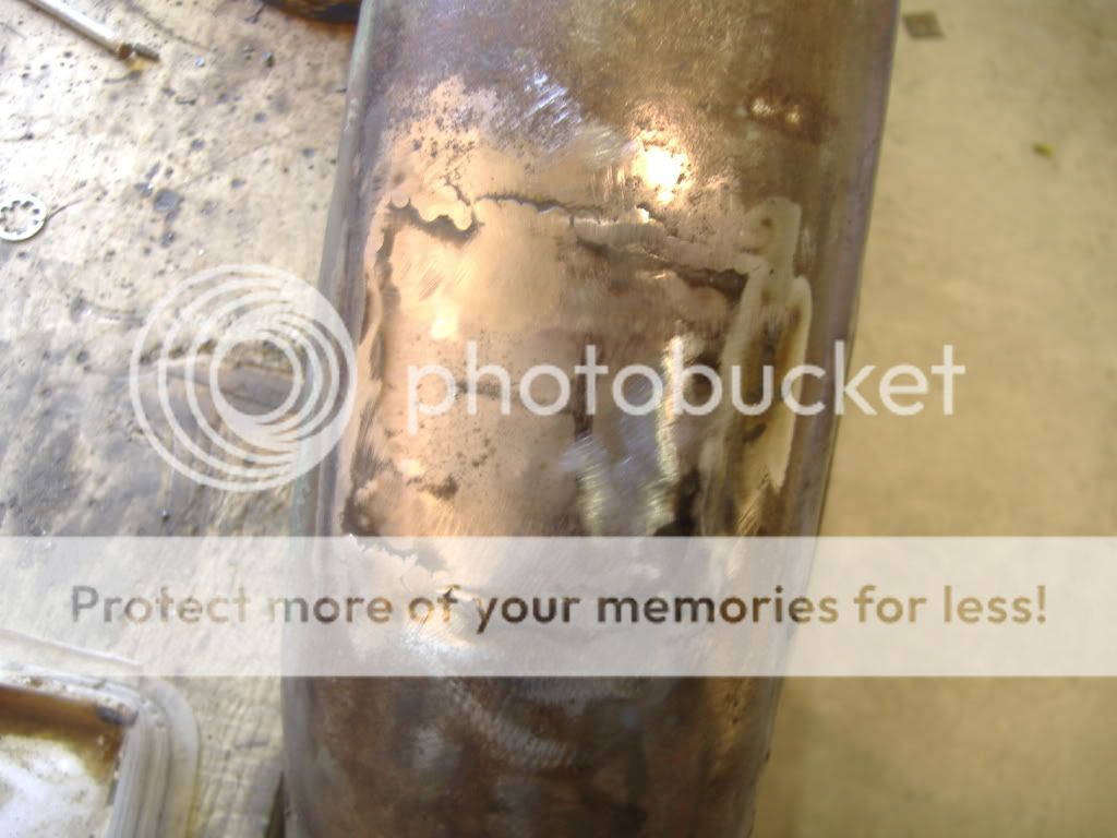

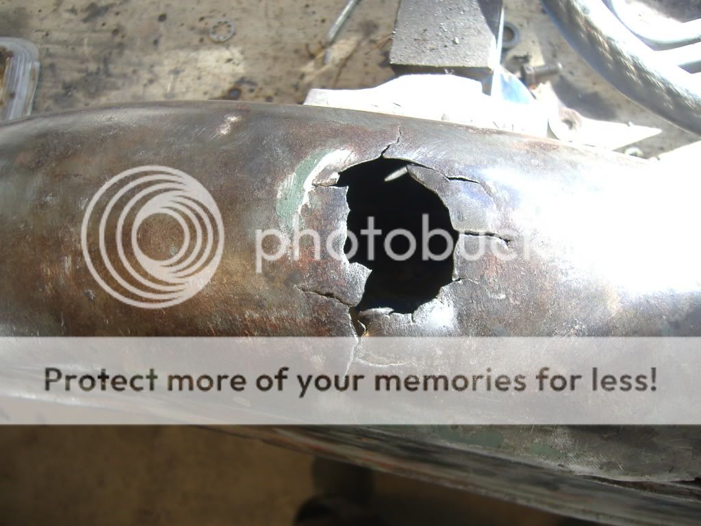

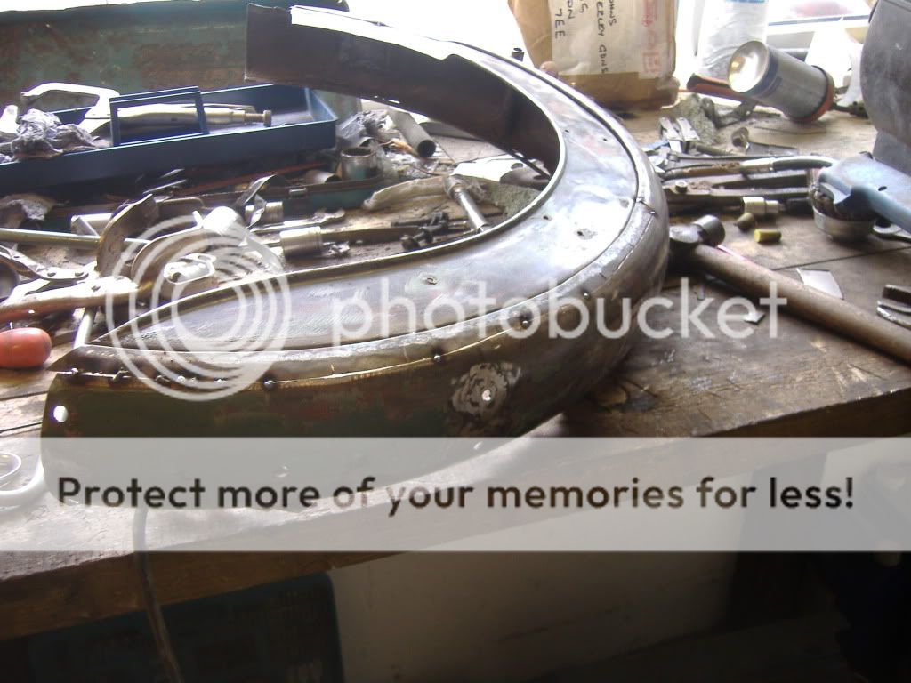

well, to do what I feel is a "proper" job, you need to replace missing/thinned metal with new metal. and to do this you need to make a new bit of metal the same shape as the old metal - as below
hole:
https://i243.photobucket.com/albums/ff114/Johnser3050/bantam%20mud%20guard/DSCF1234.jpg
repair patch:
https://i243.photobucket.com/albums/ff114/Johnser3050/bantam%20mud%20guard/DSCF1238.jpg
cleaned up:
https://i243.photobucket.com/albums/ff114/Johnser3050/bantam%20mud%20guard/DSCF1239.jpg
hole:
https://i243.photobucket.com/albums/ff114/Johnser3050/bantam%20mud%20guard/DSCF1235.jpg
repair strip:
https://i243.photobucket.com/albums/ff114/Johnser3050/bantam%20mud%20guard/DSCF1244.jpg
mudguards are tricky as they bend in two dimensions - sheet steel likes to fold along one line so you have to work hard to stretch it into the right shape
edit: whoaah - huge pics, sorry 'bout that, not sure exactly how to get neater small ones
