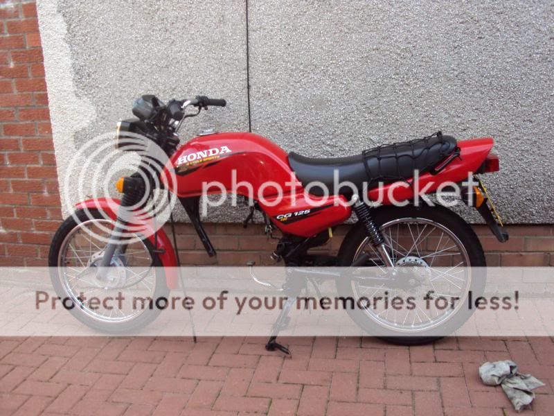

It's a W model CG125. It's from 1999. It's not the one with the electric start.
https://i14.photobucket.com/albums/a324/david_m213/cg1252.jpg?t=1317853796
Your help is much appreciated Tom. Thumbs Up
