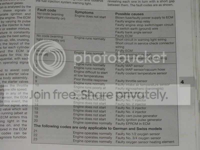

There is am engine diagnostic test!?!?!!!
..er.. I mean, ahum, yes, of-course I know. But just to, ah ... just to see if we do it the same way, how would you do that thing. The thing with the engine and er . . diagnostics?.

Nice one. Much appreciated, many thanks for your help, I'll definately try that. I am about to start doing a bit of work on the old VFR, as my VTR is now on the road. Got the tax sorted out yesterday, going to ride it for a couple of days to see if it holds up, then it's time to give the VFR some much needed attention. The VTR is a fun but slightly odd bike. And with Scorpion cans, incredibly loud. I am going to have to swap them out for originals, don't want to piss the neighbours off too much.
