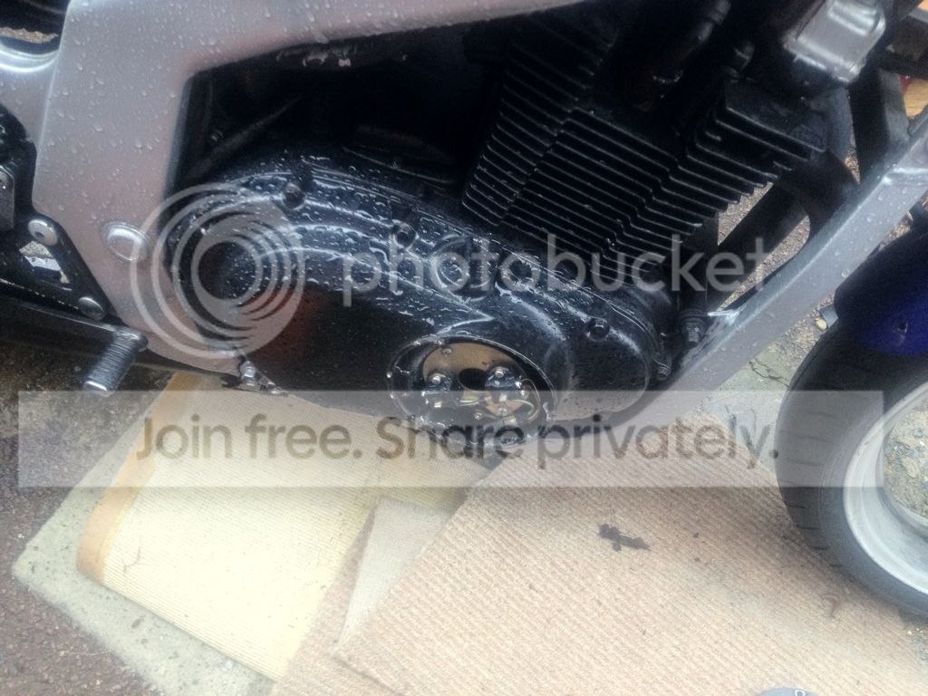

Crashed the bike ('91 gs500-E)
Total electrical failiure when it came to assessing the damage, no lights, horn, indicators, dash backlights, no starter, absolutely bugger all.
https://i1148.photobucket.com/albums/o574/_Iain_/0341dd13.jpg
This is the cover i smashed up doing it, and all the bits inside were in place, and perfectly fine. Cover took the slide, however as it's related to the ignition im wondering if the lack of electrics is down to that paying a major part in the electrical system? As far as im aware it wasnt tried with the bits under that cover in place. Or is there some sort of inertia switch (think car fuel cut off) that kills the electrics if the bike goes down? Perhaps this needs resetting if it even exists, info required.
Battery and all leads are still connected as far as i could see when going over it when i took the photo's, a few smashed indicators, but no cables hanging out or nowt, no obvious damage to battery.

In order for a short to happen the indicators would have had to be turned on.
None of the loom has any damage, or is out of place.
And the only fuse i can find is on the starter solenoid, which again wouldnt have blown or even if it had wouldnt blackout the rest of the electrical. Only the starter.
https://i1148.photobucket.com/albums/o574/_Iain_/47717ec9.jpg
As you can see, if it had reached the loom then i'd have a flat headlamp bowl, and no clocks!
Batterys still making some kind of voltage, as the satnav chargers giving me a green light on the transformer box. ____________________ Please be aware that the above post may be full of complete nonsense.

take a multimeter to the wires past the selenoid. if you have power feeding through then keep probing and see where the power stops.
you really do need to check your 20amp fuse from the starters selenoid though.
only other thing that hints towards a complete electrical failiure is the neutral switch. (read somewhere that the neutral switch can cause these symptoms)
oh and if the casing came off a key electrical part it could have shorted out while it was sliding so double check that main fuse.
dont know if you have one of these but heres a wiring diagram for a GS500e
https://www.gs500e.co.uk/wire.jpg ____________________ BCF's biggest cunt list: Cansa, Pits, Rob |

| _Iain_ wrote: | And the only fuse i can find is on the starter solenoid, which again wouldnt have blown or even if it had wouldnt blackout the rest of the electrical. Only the starter. |
Wonderful bit of deduction Watson, but what you neglected to consider was how THICK those wires going to the starter are...
Do you really think ANY blade fuse would be up to carrying that kind of load?
No, THAT will be your 'main-fuse' and its on the solenoid, because that is where the main-loom t-'s in to take its power from the battery.
CHECK IT
Presumption is the mother of all fuck-ups.
Also check you have acid in the battery!
Batteries are vented. Bike goes over, electrolyte falls out!
As for the fuse being gone, because of broken indies? Well, yes, again wonderful logical reasoning Watson.... BUT..... how do you know you didn't knock switch as you went over? And what about any other possible shorts? under impact easy for a bullet connector to pull loose and touch earth; or for a wire to pull out, or be 'cut' by something pressing on it, like a bracket.
Hundreds of reasons the fuse COULD go you have totally ignored.
I know you are in pain, BUT.... this is simple stuff, that gets solved by logical reasoning and eliminating variables, not voodoo and guess work. ____________________ My Webby'Tef's-tQ, loads of stuff about my bikes, my Land-Rovers, and the stuff I do with them!
