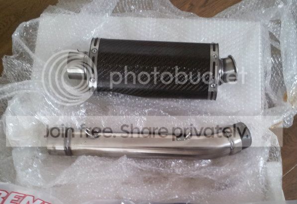

Bought this on ebay
https://i878.photobucket.com/albums/ab349/slyrob/2012-06-13141311-1.jpg
was sold as having come off a yamaha thundercat, however, the link pipe is a fair bit wider than where it should join the standard exhaust. I like the exhaust but would it be relatively cheap to get an adapter knocked up to join the two or should I try returning the item and wait another 4 months for a decent aftermarket thundercat exhaust to come up at a reasonable price?

The DRZ is like that as standard, it has a sleeve on the smaller pipe to make up the difference in diameters. Should only cost a couple of quid to have one made up.

I have the same can on my bike, it takes the noise down from 109 db to 104 db Very Happy

It may need a graphite gasket. My zx9r had one like that..

https://www.ebay.co.uk/itm/Exhaust-Reducer-Connector-Adapter-Made-to-Measure-/220687177147?pt=UK_CarsParts_Vehicles_CarParts_SM&hash=item3361fb15bb
