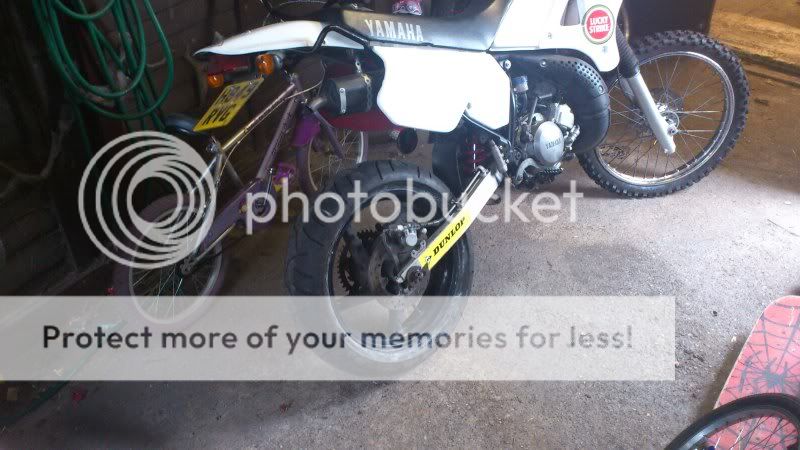

I have started to convert my old dt into a supermoto so i thought id share a few pics.
Firstly this will be a mega low budget job so no fancy excel rims.
Wheel choice was made by spending a few hours looking at a bike wheel bearing fitment guide working out what wheels would fit the spindles as easily and cheaply as possible.
In the end i went for aprilia rs125 wheels, i have bought the rear wheel first as it was always going to be the hardest to get to fit due to needing disc and sprocket lining up.

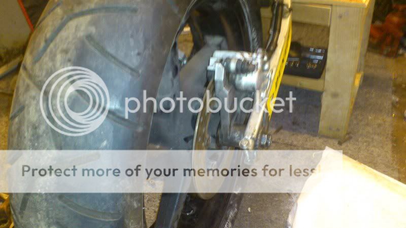

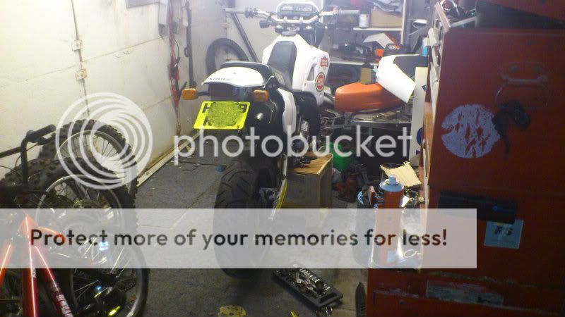

The trial fit went very well as the dt caliper fitted with no mods.

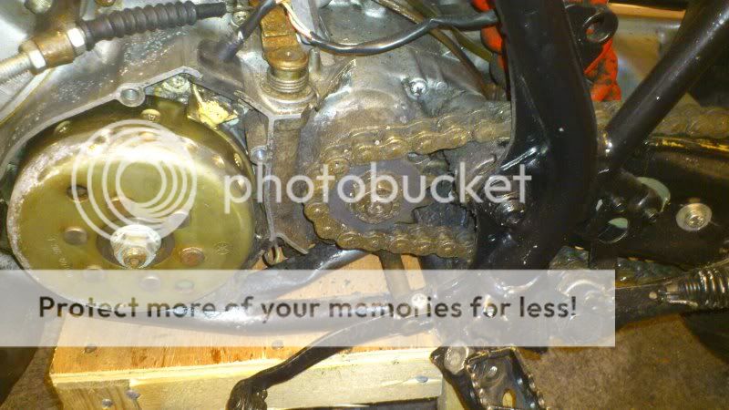

Then came the next problem as the sprockets were a different pitch
easily cured with a yz125 front sprocket.

Then i was shocked both the disc and sprocket lined up with no mods.
https://i46.photobucket.com/albums/f115/vw1972/DSC_0139.jpg
I just need to make some spacers and the rear wheel is done.
