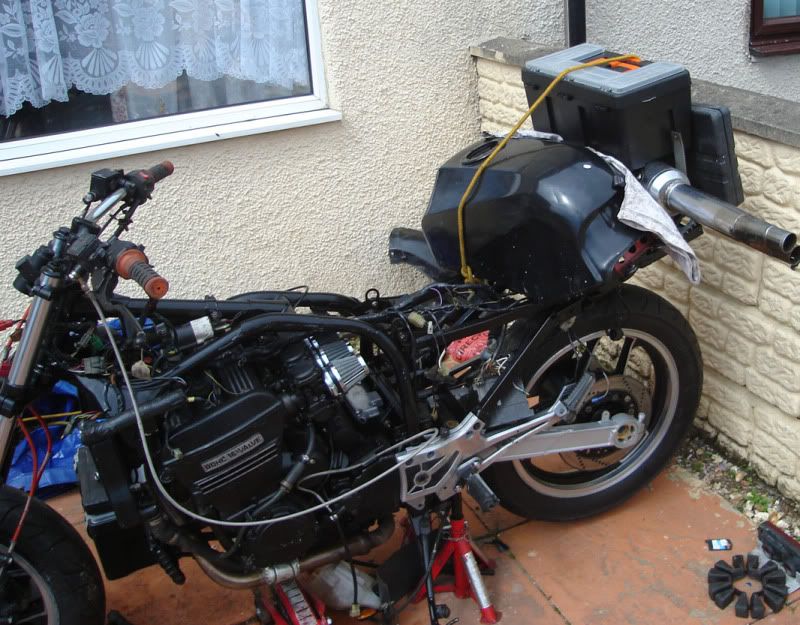

I've used a trolley jack most times.... even left the bike on the jack on the driveway overnight and still found it upright the next morning
Or if all else fails.... use whatever you can find to weigh the back of the bike down:
https://img.photobucket.com/albums/v320/andy36586/GPz750/balanced2.jpg

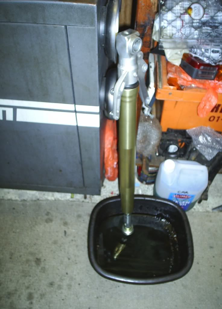

I have both stands for the front ends of my bikes.But for servicing the headrace bearings I use a plank of wood ubder the engine after removing the exhaust downpipes.This allows me to not only work on the front end,but also gives me an opportunity to clean the underside of the engine and the exhaust
https://i666.photobucket.com/albums/vv23/WiNot_Rhencullen/Workshop/Picture462.jpg
When draining out the fork legs of old oil,it is a good idea to pump the damper system when inverted and leave the old oil to drain out...overnight if possible Thumbs Up
If the old oil is particularly grotty,then I have used a very thin oil to flush out any debris in the fork,before pouring in fresh new stuff
https://i666.photobucket.com/albums/vv23/WiNot_Rhencullen/Workshop/Picture466.jpg
