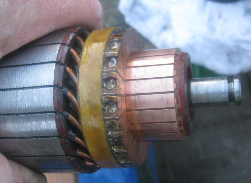

That sounds very like it's the starter motor itself.
Don't know how familiar you are with an electric motor but there's almost certainly a problem with the commutator.
If the motor stops on a "bad sector" it can't turn. Your wee bump forwards will rotate the starter motor slightly so the brushes are on a good sector and it'll then work.
We had to do this for a week or so with my Dads toyota hilux one time until we had time to change out the motor.
To test this, try shorting across the two terminals on the solenoid with a coin/screwdriver next time it happens. The starter motor should turn regardless of any other factors because that effectively connects it directly to the battery. If it doesn't turn and the battery is good, the problem is the motor
If the starter motor is strippable, it might just be a build-up of carbon between the commutator segments, taking it apart, scraping the carbon out with a fine screwdriver and cleaning up the surface with some fine wet and dry paper can do the trick. Inspect the brushes while you're there. COuld also be a broken wire going to the commutator.
It may also be the case that it's a sealed unit and just needs replacing.
The commutator is the copper bit on the attached image (which is a generic starter motor picture). The grooves between the segments should be free from carbon and the surface should be clean copper.
