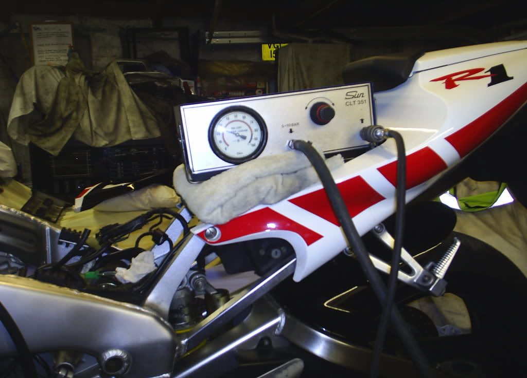

This is the leakdown tester that I utilise.
https://i666.photobucket.com/albums/vv23/WiNot_Rhencullen/Workshop/Picture419.jpg
With the combustion chamber full of compressed air,the dial shows the amount of air pressure lost as a percentage.
I listen for escaping air at the carbs for inlet valves leaking,exhaust pipe for those valves and the oil filler cap for piston ring leakage.
When we performed the compression test on Paddys bike when he was here the other Saturday,a small syringe full of engine oil bumped up the compression test by quite a similar amount on each cylinder,but still not good enough for decent combustion.But what the tools do perform is an indication of where to look next.
