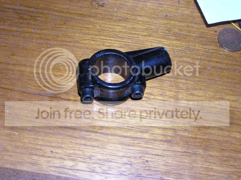

Vincent wrote:
Raffles wrote:
Both of my mirrors have L/H threads. I'll have to try to remember to only crash on the offside Razz
Well that is unusual. What bike is it?
My Honda SH300 has left hand threads for both mirrors, but the stalks the mirrors screw into are themselves right hand threaded in their attachment points on the handlebars. So they can come undone with too much force either way.
