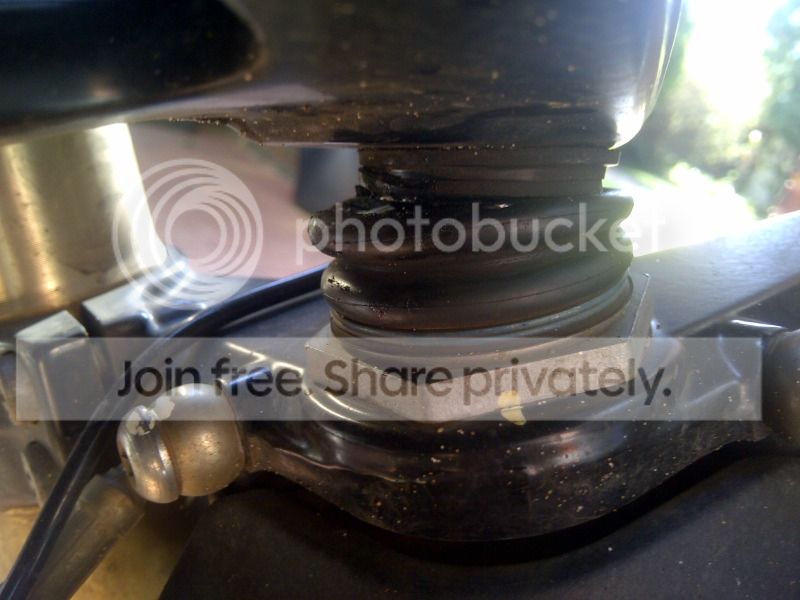

Think I found the problem. Put the bike up and saw the rubber seal around the upper ball joint is torn. Grease leaking out. I guess sand and dust must have gotten in there riding off road and worn out the joint. Our hot dry weather and rutted roads hard on bikes.
I hope it is just that. R1800 for a new one. F..k shit kak bliksem poes. And must bleed brakes. Friend of mine is an ex bmw mechanic and said he will do it for R600. Need that tool to remove the joint and a 230 nm torque wrench to refit.

Kradmelder
Joined: 13 Jun 2012
PostPosted: 09:08 - 10 Sep 2012    Post subject: Reply with quote
cause of the problem. I guess the sand you see around the joing must have got in there and worn the ball joint
https://i106.photobucket.com/albums/m270/hvandermerwe62/IMG-20120910-00386.jpg
Part from BMW arriving today or tomorrow
