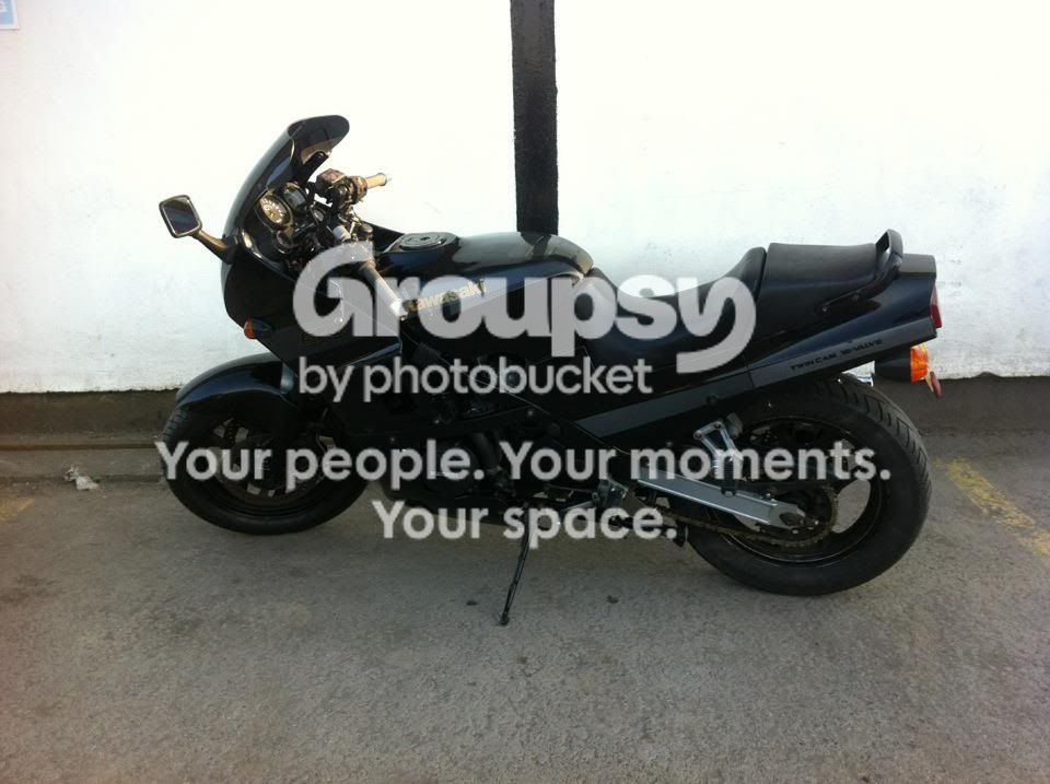

£400 was about right I thought as the overall condition is good other than the issues lol. Its done 40k, but I have seen many go way over that. I will probably keep it 6 months and then look for something else. I have spent so much on the CBT, theory and DAS that it didn't really leave me any real cash for something nicer. I do like the look of the GPZ, I just find it feels so small after riding the ER-6 on my training/test. I like the bulky feel of the bike and its black Very Happy
