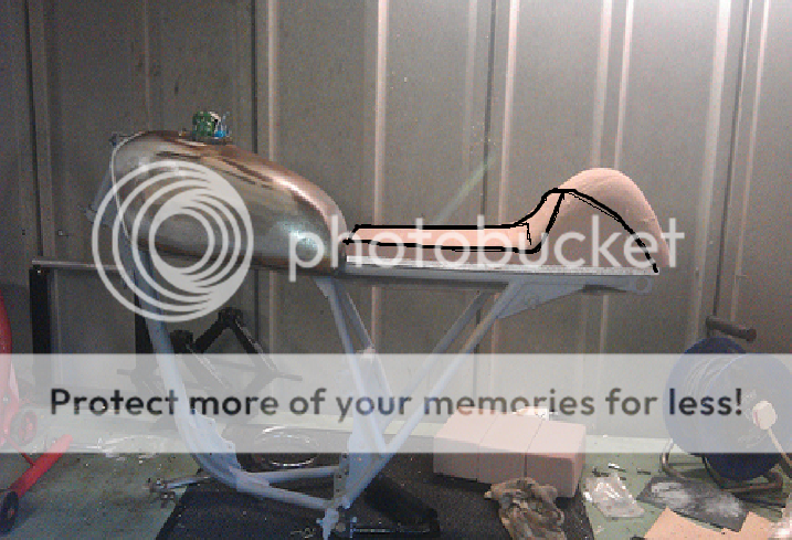

Just a thought but thought this would be cool Smile
https://i56.photobucket.com/albums/g164/Blurredman/Untitled-13.png
Suzuki TS 50 1999 Honda CB 125 t2 1981 Yamaha XJ 600 s Diversion Honda cx 500 MZ ETZ 250 1985 Yamaha FZR 400 1981 Suzuki TS 185 1984 Triumph bonneville 790 2001 MZ TS250 1979 Suzuki sv 650 1999 KTM exc RFS 450 2007 Hercules mx 125 1976
lihp
Joined: 22 Sep 2010
PostPosted: 20:36 - 02 Aug 2012    Post subject: Reply with quote
great minds think a like! No progress today though as did my ankle in at work so not up and about so much in the garage tonight, but I will have a new mould by end of the weekend
