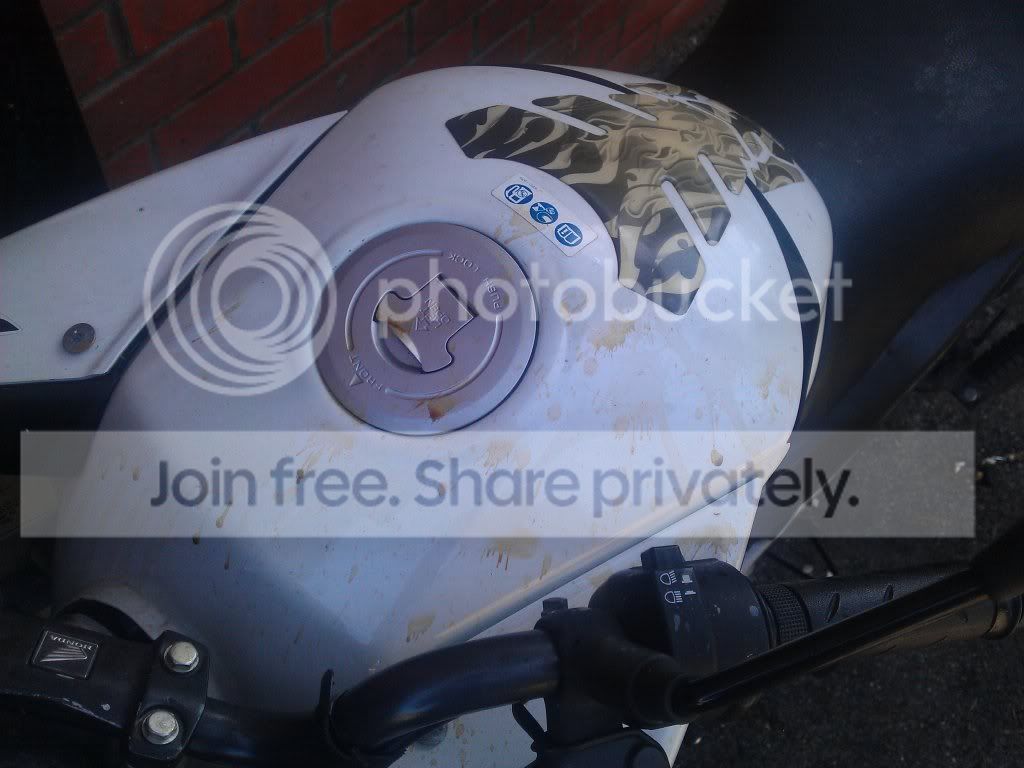

The night before last my bike was vandalised and all of the electrical cables I could see had been clipped through. the ones leading into the electric start module, the wires leading to the horn, the wires leading down into the engine block. There was also a lot of coke poured over it which has dried in a nasty sticky brown mess. Aside from the general clean up I am going to need to give it, is there any information anyone can provide with regard to re-wiring it all?

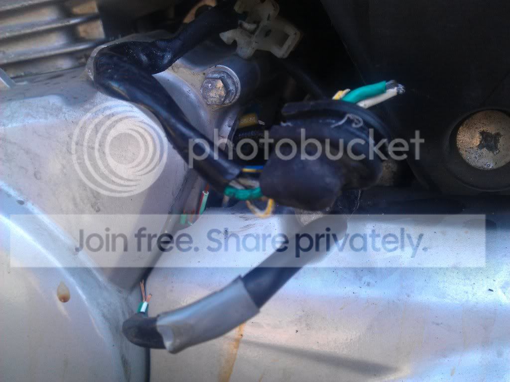

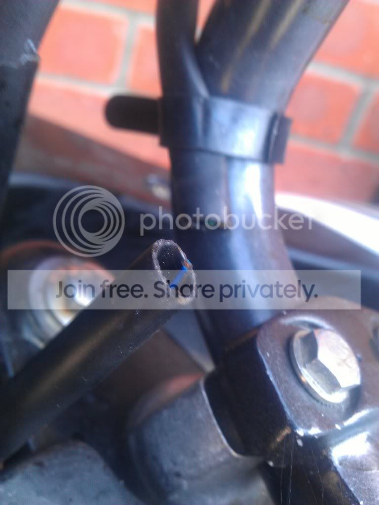

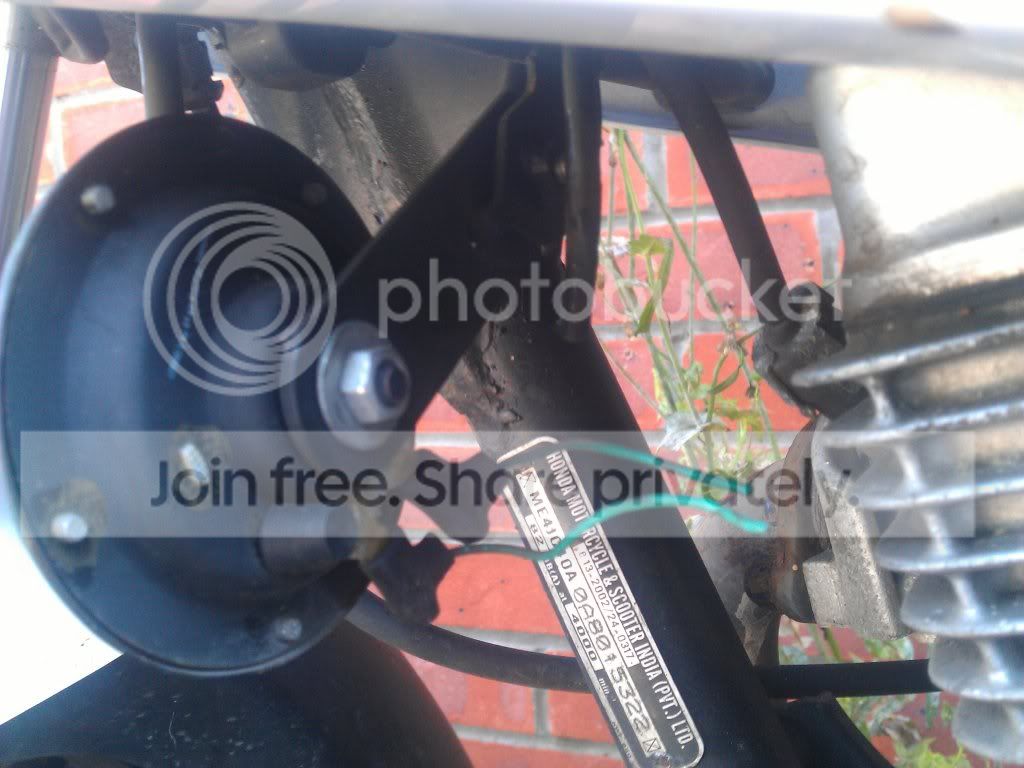

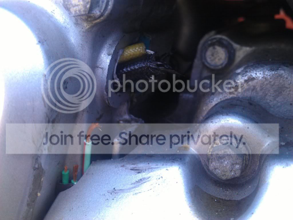

Thanks for an overwhelming response everyone. as requested, here are some of the photos I took of the damage.
https://i1267.photobucket.com/albums/jj558/rewkero/36d51eed.jpg
https://i1267.photobucket.com/albums/jj558/rewkero/c1865b11.jpg
https://i1267.photobucket.com/albums/jj558/rewkero/f863a432.jpg
https://i1267.photobucket.com/albums/jj558/rewkero/7fafa6eb.jpg
https://i1267.photobucket.com/albums/jj558/rewkero/301898d6.jpg
The cables severed down near the engine block worry me the most because there isn't much left to re-attach to. Sad

They even cut the horn wires? Laughing
There's nothing there that'll be impossible to solder back together, although it is now quite firmly entrenched in ballache territory.
You only really need to expose a couple of mm at each end of the severed wire to be able to solder it back together properly, so don't go wild stripping back all the insulation you can find. If you don't have any heatshrink, pvc tape will do, but it won't hold on particularly well - ideally, you want to heatshrink the exposed connection, and then wrap it in self-amalgamating tape.
Just be slow and methodical, and it'll be fine.

at most that will cost about £20 to fix including buying a soldering iron, some solder and some heatshrink. id also buy some proper wire cutters or strippers as they'll make your life easier but the main cost to you will be time. as has been said use the wiring diagram above and just go round slowly doing each wire one at a time. you'll probably have a couple of blown fuses to replace aswell. a multimeter (£5 maplins) would be another worthwhile investment for this job so you can confirm each wire against the diagram to make sure there right

As others have said re-solder each wire & use a shrink wrap sleeve, you might need to add some extra wire in a few places as it looks like you haven't got much spare wire to play with. All do-able though, plenty of tea and some patience. Thumbs Up
