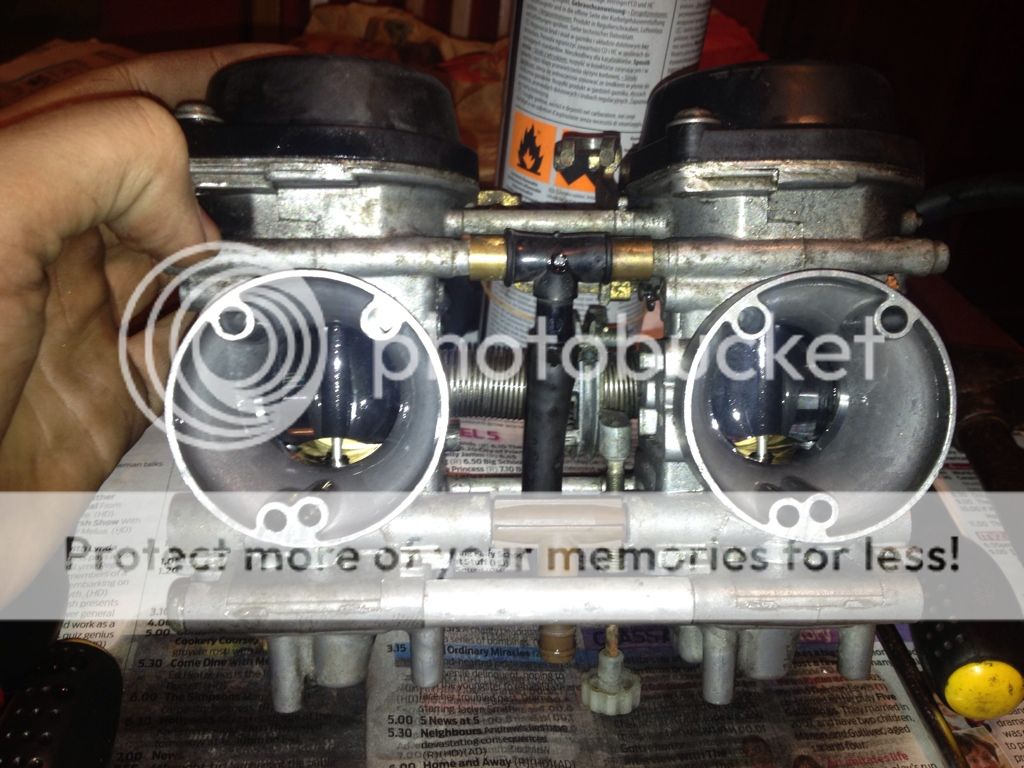

looks like youe tank is full of crap, drain the the tank and remove the crap, maybe see if you can seal it up (that what i did with the rust in my tank). why is nobody ever expects it to tbe the tank itself
PostPosted: 10:51 - 21 Sep 2012    Post subject: Reply with quote
Well, it's getting there either via the fuel line or the air intake.
Looks like fuel crud, but how's your air filter? Not disintegrating? No crud coming up the crankcase breather into the airbox and getting past the filter?
Sorry for the obvious question, but are you planning to sell it as soon as you get it running, and if not, why not? For a cheap bike, it seems to be costing you a lot. Sad

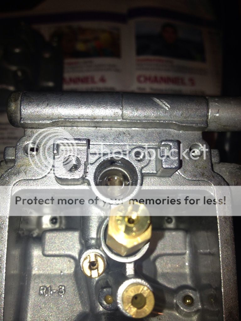

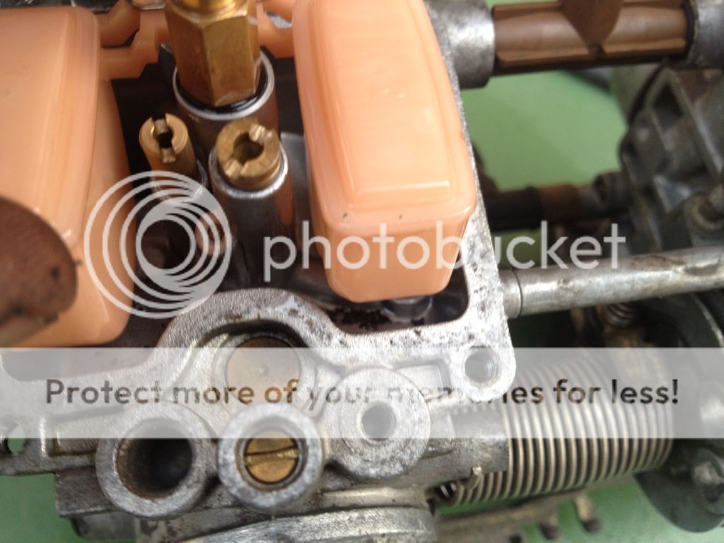

Could be a sticking float if after cleaning jets thoroughly?
Get some fine wet/dry sand paper roll it it tightly and twist it several times where the float valve slides in/out, and finish off with some carb cleaner. Sometimes a build up occurs there and it's just enough to make it stick and not allow further fuel into the carb or very little.
Install an inline fuel filter just in case, but I've cleaned carbs sometimes spraying it with just a can isn't enough that's why using air gun type instead is better making sure it pushes it all out from the carbs with no where to hide!
