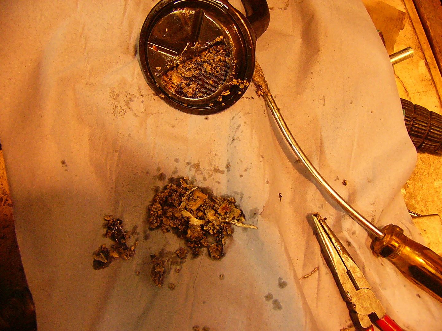

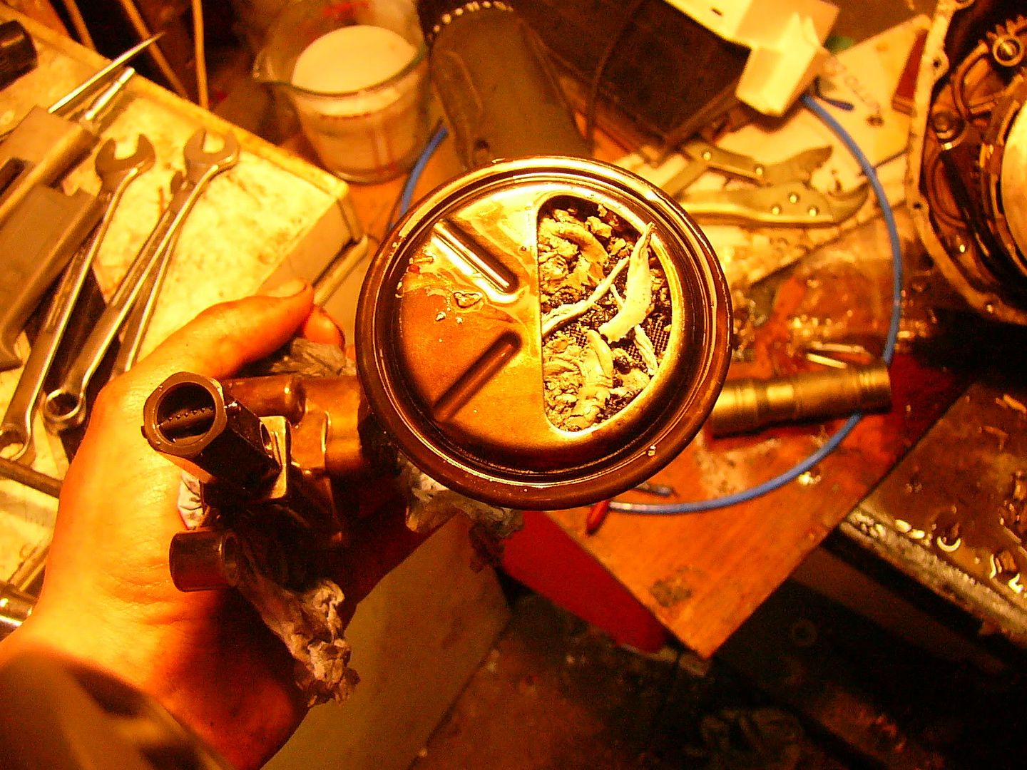

I can beat that!!
https://i56.photobucket.com/albums/g164/Blurredman/P1060877.jpg
https://i56.photobucket.com/albums/g164/Blurredman/P1060881.jpg
It caused oil starvation in the top end of my cx and now the cam is a mismatched lump of metal.
