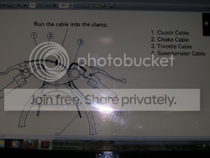

Hi took the fuel tank off and have access to the throttle cables, Its 2 cables and they go through a hole at the front to the right of the steering, There are also a few other wires, have tried to seperate the other cables the best i can.
When i turn the handlebars to the right the cables are bending round and hitting the frame where the cable goes back through the frame hole.
The throttle becomes sticky and the engine revs when the handlebars are turned to the right.
Im stuck now with what to do i dont know if the cables are going through the correct frame hole, i have oiled both cables at the carbs,
any help/suggestions would be appreciated thanks

The cable routing is in the first section of the manual I linked.
