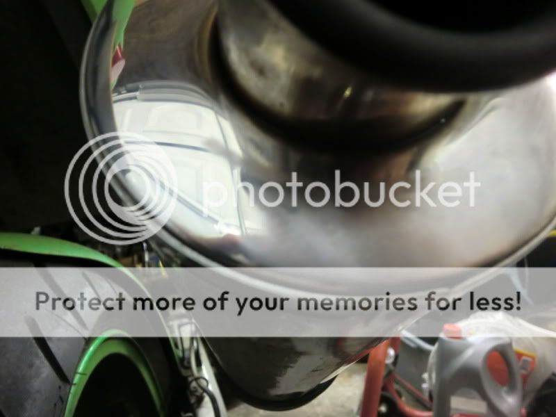

The previous owner fitted a race can to my bike and used a dremel to remove the "not for road use".
It has left the tip half mirrored and half matt.
I was wondering what would be the best way to return it to a mirror like finish.
https://i14.photobucket.com/albums/a324/david_m213/CIMG0627.jpg
I was thinking of using autosol on it but I don't want to give it a go and make it worse. Is the mirror finish seen on the upper half a chrome coating or is that the actual metal?
Thank you for any tips on getting this back to how it should be.

Polishing stainless, which is probably 316 type, in that state by hand would take forever. You really need a polishing mop, one on a bench or angle grinder is best, dremel would be OK but an ordinary electric drill isn't that good (not fast enough rpm)
It isn't plated it's just highly polished stainless

Thanks Bezzer. I was thinking of getting an angle grinder soon anyway so might go for it. I've never polished anything before with a mop. Do I apply autosol type polish to the piece and then go over it with the mop?

you use polishing compounds . they are like a block of crayon . is how i can best describe them
there are different coarse mops and compounds to use .
if your preparing a piece thats not been polished before
you would want to sand it to as smooth a finish as possible first
then
a sisel mop is usually the first and on most metals a black or grey compound . the sisel mop is the most coarse and will take out the fine grain left from sanding and some scratches
followed by a close stitched mop with a green compound
then a loose stiched mop with a blue or white compound
thats 3 stage polishing . whatever metal you polish with that process you will get a mirror finish with .
clean inbetween stages with white spirit or meths . you need to have all the previous compound off before applying another or it makes your mop gunky
basic order of compounds used for almost all metals is
black/grey
green
blue
and it you want white . white is more soft metals like gold rings and stuff if i remember rite .
but for what you want to polish just a close stiched or loose mop and green compound will make it a mirror finish .
i was polishing just today . i started doing it a few years ago and it was addictive for a while . i started to polish just about everything . bars ,calipers,resevoirs,wheels,tanks,engine cases. all sorts you get the bug for it after doing it once .
make sure to rock a dust mask n some goggles. the crap gets up your hooter something silly and all over your boat race .
i have done a lot of it with a drill before . it demolishes drills . for that small bit you have to do tho theres no reason you couldnt . you dont need a special tool just push a bolt through the mop with washers on and then a nut on . then just put it straight into your drill . you dont need to apply very much pressure when polishing
green compound . you dont need to use much 500g is enough to do every single piece on your bike . little bit every now and then when polishing
