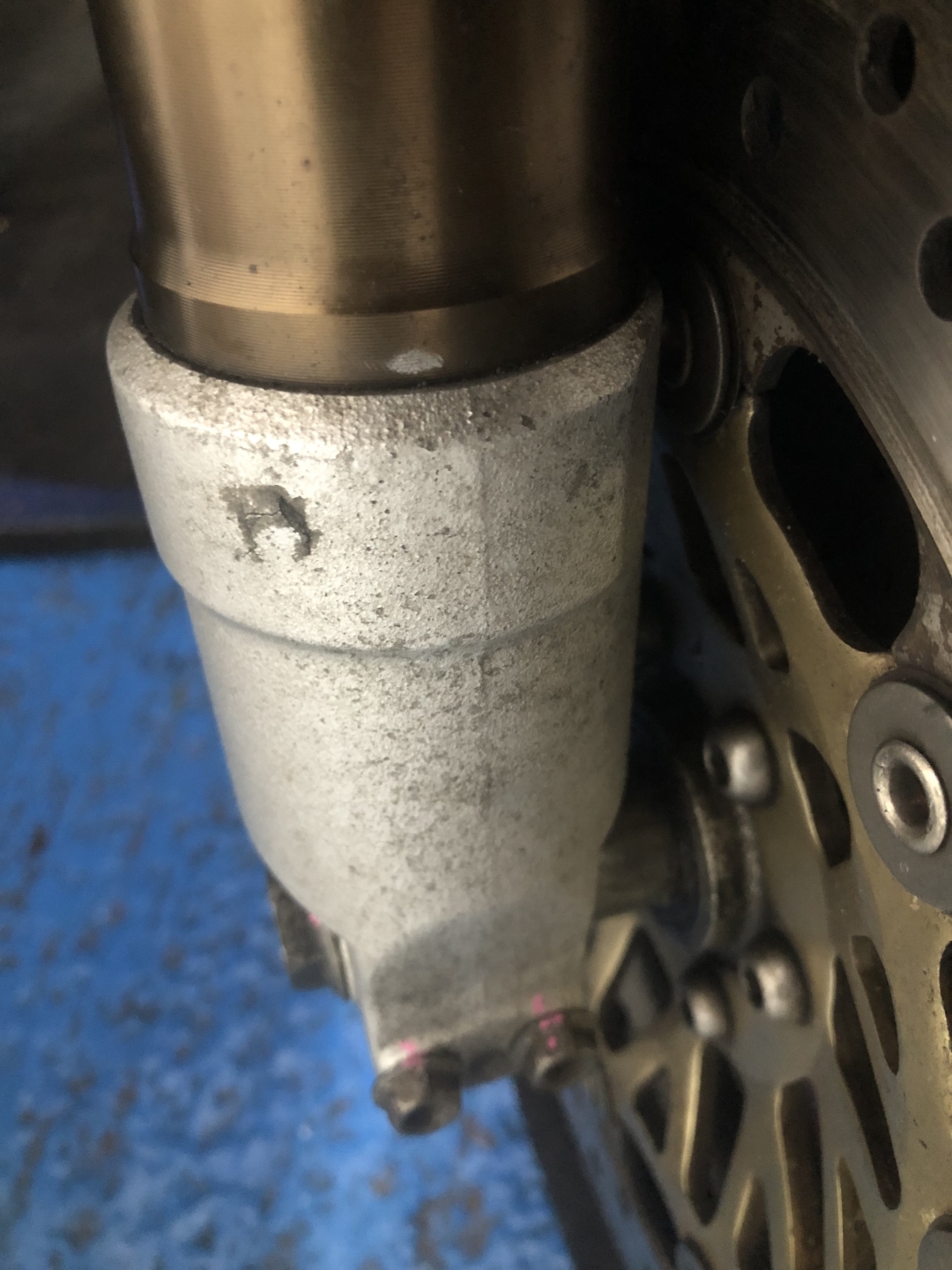

A week or so ago I took the first steps into remedying the worst of the issues on the 'Blade. The first and most obvious issue was the engine rattle, which if not fixable could well be something terminal. I had a strong suspicion that it was a camchain tensioner issue, but I couldn't be sure until I had done some digging.
https://www.bikechatforums.com/files/img_0070.jpg
A little context - As some of you might know, my last track bike was a 2007 Honda CBR600RR. As lovely as it was to ride, it was an absolute pig to work on. This bike had a manual camchain tensioner fitted, which was just annoying, and not particularly easy to adjust. I had bought a replacement OEM automatic item from Fowlers or somewhere, and when it arrived it was pre compressed and had a little tool inserted into it (a stamped piece of T shaped steel) to hold the tensioner in place for fitting. Of course, being a compulsive fidget I removed this tool before time to see what happens, and this caused the spring on the tensioner to extend, pushing the tensioner plunger out. It took me a slightly sweaty and tense few minutes to work out how to use the tool to twist the plunger back in, and drop it into place to hold the tensioner back as the factory had intended. This gave me a picture of how Honda designs their CCTs and set me up for the first bit of work on the 'Blade.
https://www.bikechatforums.com/download.php?id=104015

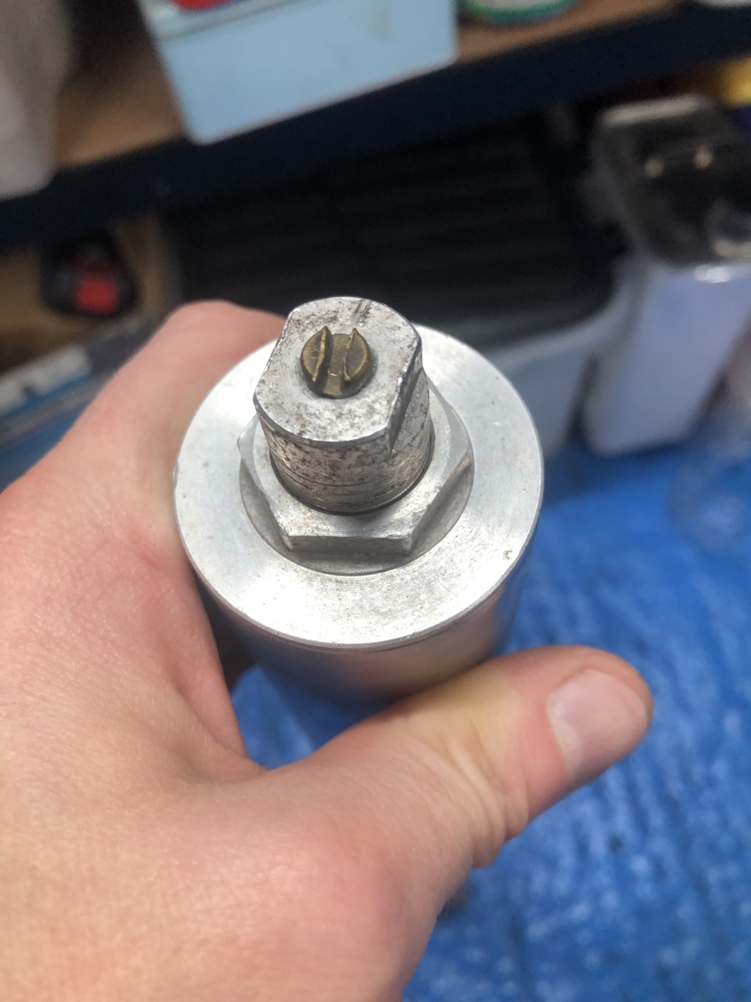

I removed the 'locknut' from the end of the camchain tensioner body (which was suspiciously finger tight...) and looked inside. I could see the slot in the plunger that a flat blade screwdriver could fit into, and I picked out a tiny watchmakers screwdriver out of my toolkit. I turned the plunger about 2-3 turns, and then whipped the screwdriver back out. The plunger popped back with a satisfying 'click'. I then refitted the 'locknut' (lock bolt...?) and tried starting the engine. It's definitely MUCH quieter! This may not be a permanent fix, but it at least shows it's not a big end bearing or something.

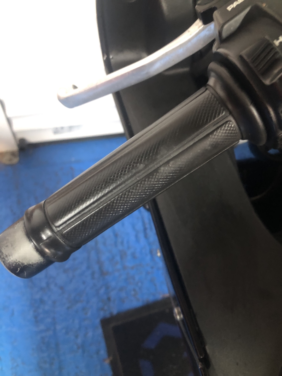

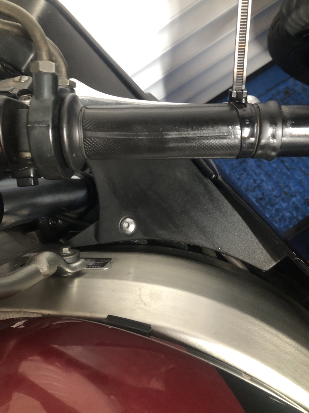

Arrow The handlebar grips are REALLY worn, so I've got a new set to fit

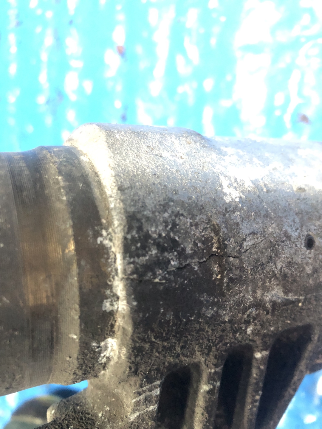

Arrow Left fork top - It's mullered, but I do have a set of fcuked forks from ebay for no money with a pair of clean fork tops. I'm not sure how much work it is to dismantle the forks and replace the tops...

Arrow Replacing handlebar grips. A horrid job that I dislike immensely, I did not want to ruin the day by attempting it. Given another free day with no other jobs to do I will do it, but it doesn't stop the bike from being rideable.
Arrow Replacing the mullered fork top. As with the grips, this won't stop me riding the bike and it needs some time to work out how to disassemble the spare fork leg, and to swap the parts without causing too much bother.

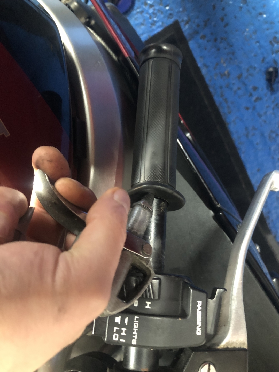

I tried using my compressor with an air blow gun to help remove the old grips. Surprisingly it works really well and made the whole process much easier than I thought it would be. You press the trigger and slide the grip down with your other hand.

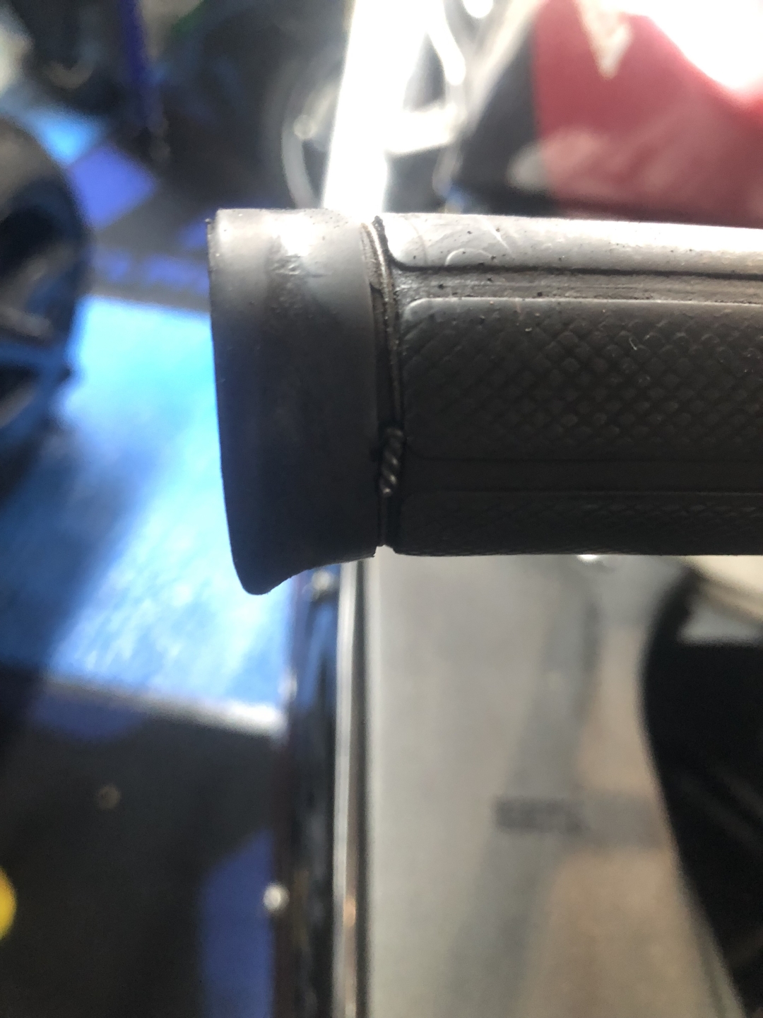

on the throttle side, I weirdly found that the old grip was lockwired on:
https://www.bikechatforums.com/files/img_0229.jpg
Easy to cut with snips though.

I've also fitted two sets of heated grips and regularly put Renthal extra soft grips on my track bikes, so I happened to have some Renthal grip glue in my tool box. It's not a magic potion though, it's just normal cyanoacrilate superglue. It might well be cheaper to buy than a branded superglue though!
...and finally a pic of the new grips fitted. It looks so much better to my eye. You can't tell as much in the photos, but IRL it looked awful and now it looks great.
https://www.bikechatforums.com/files/img_0230.jpg

The right hand fork bottom has cracked, as Sickpup warned about earlier in the thread (or possibly in the other thread?):
https://www.bikechatforums.com/files/img_0233.jpg
The ones on the bike don't have cracks in those places. It does have a weird bulge on the left hand leg which I am a *little* concerned about, but I think it's on the overlapping part between the bronze coloured tube and the cast alloy fork foot. I'm thinking it's not dangerous, but needs an eye kept on it:
https://www.bikechatforums.com/files/img_0234.jpg
I might put a layer of chemical metal over it or something. I suspect it could be welded, but I don't know if it's worth the hassle.
