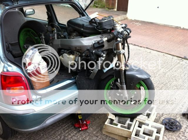

A few weeks later I picked up another one in a worse state. Non running with no bodywork, though the engine turns over. Anyway they then got left in the garage/garden for ages. Now I've finally cleared out my 'workshop'/conservatory I'm going to start my project.
Aim is to have one road bike and one track bike, so all the cosmetically nicer bits go on the roadbike and all the more trick bits go on the trackbike.

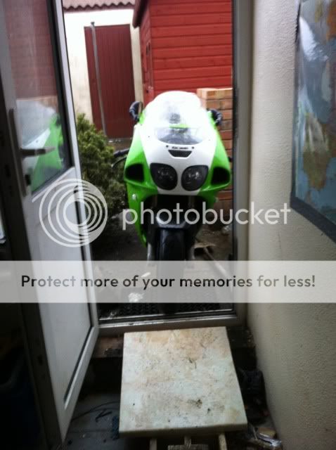

First difficulty was getting the fuckers in the house. Scrappy went in with no major problems - I removed her brakes as they where seized on, the nicer one was a little more troublesome-
https://i35.photobucket.com/albums/d170/tristanthe/Snapbucket/51DB2751.jpg
stupid chubby ninja is too heavy to get over the step.

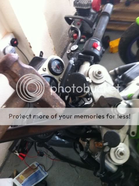

Now I had a bit more room I could put the steering lock on, which made the ignition work. Then I popped a working battery on the nicer one and got her running. Horrible clicky noise from the RHS of the engine though, I'm assuming these run auto CCTs, might look into a manual one. Didn't bother putting a battery on the other one, I'll drop the oil first and see if there's anything nasty in the sump.

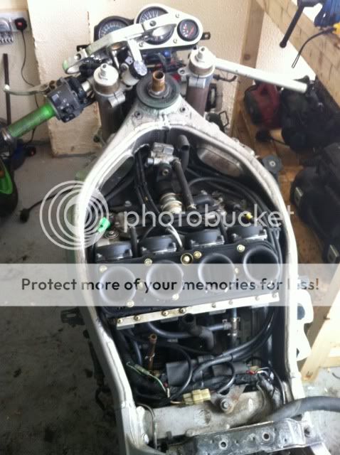

https://i35.photobucket.com/albums/d170/tristanthe/Snapbucket/F600177B.jpg
scrappy is actually much cleaner under the tank than the other one

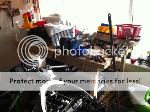

Oh and I'll quickly pimp my homemade workbench - £15 of discount timber and about £20 of threaded bar and coach screws and some free pallets

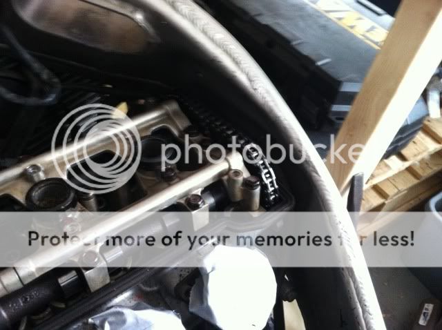

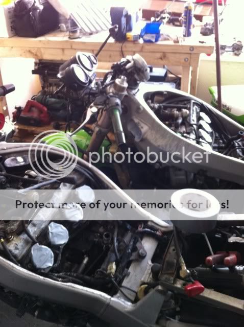

Spent the afternoon getting the valve clearances measured. Tried to take a few more pictures this time, as I realised when I was writing up what I did last time there where bits I meant to have pictures for. TBH this stage of the project is fairly boring. I'll make sure to take more pictures when shiny bits start turning up and stuff starts fitting together.

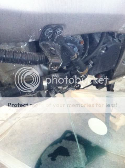

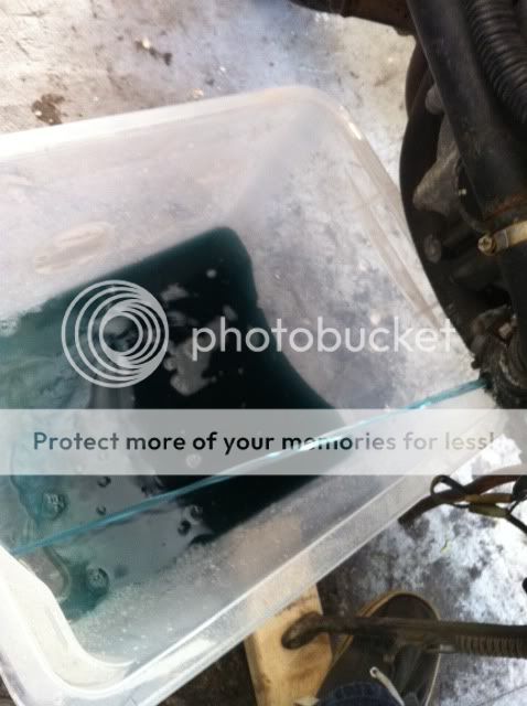

Anyway both bikes did a nice blue wee, no rust or kidney stones
https://i35.photobucket.com/albums/d170/tristanthe/Snapbucket/8ADBED0C.jpg
https://i35.photobucket.com/albums/d170/tristanthe/Snapbucket/A5EB8EB0.jpg
So then I could get the carbs off
https://i35.photobucket.com/albums/d170/tristanthe/Snapbucket/C14C9F1C.jpg
Normally I dont name bikes, but since there's two of the same it kind of makes sense, the far one is scrappy ninja as she was originally in a bit of a state and the near one is chubby ninja, as her brake callipers are still fitted and binding, so she feels heavier

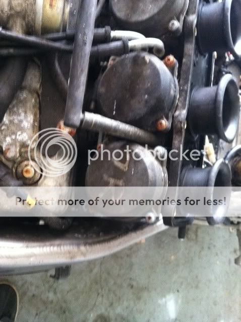

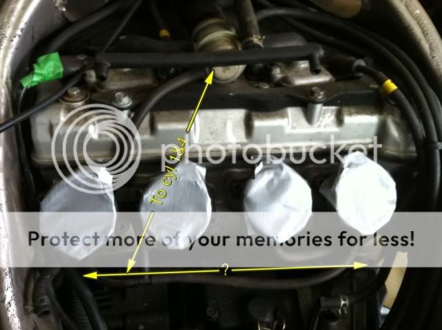

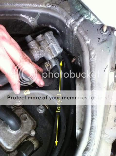

There's a whole lot of stuff on top of the engine, I'm assuming it equalises the pressures in various parts at various times. I took a couple pictures so I know how it goes back together
https://i35.photobucket.com/albums/d170/tristanthe/Snapbucket/BC79843E.jpg
https://i35.photobucket.com/albums/d170/tristanthe/Snapbucket/2AD9F897.jpg
Then I gave the head covers a quick clean, to stop and dirt falling in the head, and took them off
https://i35.photobucket.com/albums/d170/tristanthe/Snapbucket/22A2FA13.jpg
stupidly tight clearance to the frame.
I did the bikes one at a time, and as scrappy was too close to the workbench I couldn't easily turn her over (crank access is on RHS) so I had to reshuffle, was about to get started, then I realised, the tools I needed where...
https://i35.photobucket.com/albums/d170/tristanthe/Snapbucket/BB7D128A.jpg
right over there, had to do some bike parcour
Anyway checked scrappy, refitted head cover and checked chubby

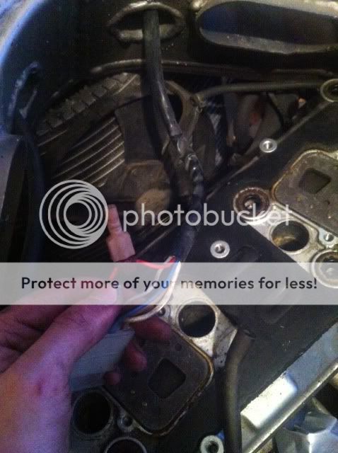

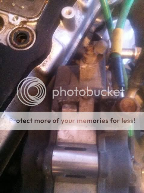

Quick question, any idea wtf this is?
https://i35.photobucket.com/albums/d170/tristanthe/Snapbucket/B34943B4.jpg
I initially assumed some bodgy home DIY connecter block, but it looks weirdly focussed, like it has some very specific purpose

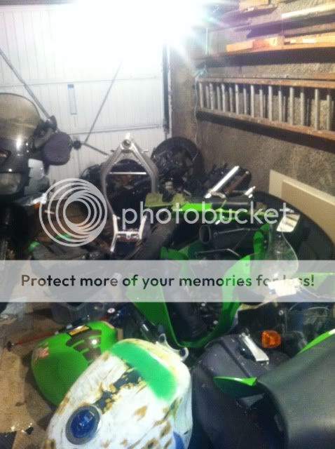

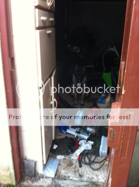

Finally, then I cleared the unneeded bits to the garage, where the dog had been sat in a strop for a good hour or so
https://i35.photobucket.com/albums/d170/tristanthe/Snapbucket/45EF8398.jpg
erk, garage is getting very full
https://i35.photobucket.com/albums/d170/tristanthe/Snapbucket/73497C80.jpg

I believe the bit on top is a valve that opens to let air from the intake into the exhaust port to get rid of unburnt fuel. It's all in the haynes book of lies

The ignition switch issue will be a badly soldered wire inside the ignition barrel. Youll have to take it off and re solder it on. I had to do this on mine, been fine since. They also tend to burn out the big connector block for the ignition under the tank, so take a look there.
As for the vent gubbins under the tank...
You can remove the valve sitting ontop of the rocker cover and just bridge to 2 pipes together. The other valve regulates pressure into the float bowls on the carbs. I would HIGHLY advise you keep that, as its a nightmare without.
Are they cast iron discs?! ( PFM?)

Cheers Alex. With your issue with having to resolder the ignition barrel connectors, did this physically stop the key from turning? That was my issue, just wouldn't move till it felt like it was about to snap in the lock. I plan on keeping the assorted air recirc stuff, I might later chase more power an less weight but for now I'll just get it running well and put some miles on them, the mystery thing I was actually asking about in the picture was the weird connector block.

It looks like 7 of my clearances are out of spec, annoyingly it's 6 on 1 engine and only 1 on the other so next job is cams out to measure shims. Will decide tonight if this is going to be possible with the engine fitted or if it will make sense in the long run to drop them.

Try pushing the key forward or back in the barrel when turning the key.
Some ignition barrels wear funny from people having too many keys on the keyring.
The block connector is the one im talking about. Altho im not sure why it has a random spade connector on it!
I have changed shims in my 7r with the engine in the frame mate, all I do is mark the cam shaft sprockets and cam chain with a dab of tip-ex, as seeing the alignment lines is impossible with the frame in the way.

Alex, I sorted the key, when I had room to put the steering lock on that freed it up, now you point it out it's obvious what that block is, a fancy scotchlock type thing, presumably it was wired into some accessory so it would be live with the ignition on.
Bacon, ta for the tip. I had considered marking them. I think I'll take a few days to decide, I have other things to do in the meantime. I think I probably will end up dropping it though, just for the extra confidence.

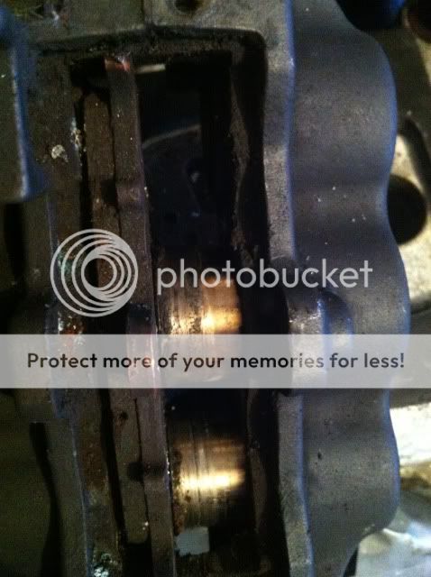

So the last couple of days I've started looking at the brakes. Utter bastards every step of the way
https://i35.photobucket.com/albums/d170/tristanthe/Snapbucket/33851446.jpg
Only 1/8 of these retaining screws rounded, which I was quite happy with.
https://i35.photobucket.com/albums/d170/tristanthe/Snapbucket/ACAAFF8F.jpg

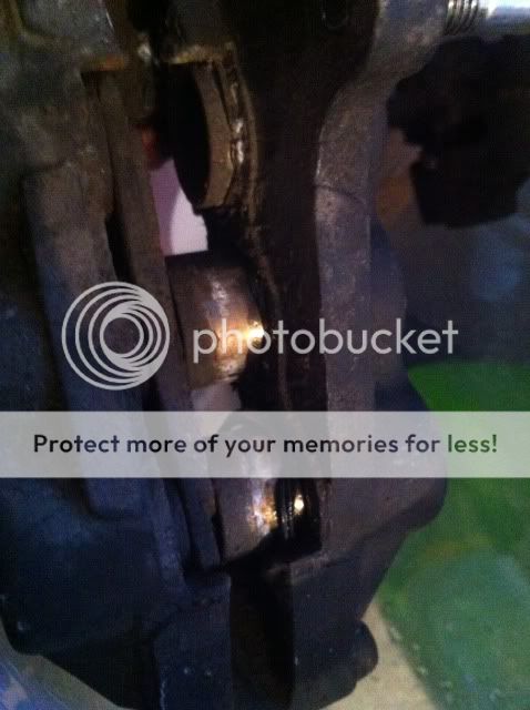

Filthy horrible calliper. The pins where an absolute prick to get out - I would advise leaving them on the bike, clamping a set of mole grips on the pins as tight as physically possible then just working the pins round for a few minutes before you bother trying to slide them out.
Next I decided to work the pistons out hydraulically as much as possible - using an air line is fiddly, and if one piston blows the seal it means the rest are much less likely to come out.
https://i35.photobucket.com/albums/d170/tristanthe/Snapbucket/00ACA839.jpg
Unfortunately one set of brakes blew a seal almost instantly. So these will have to be attempted with compressed air.
https://i35.photobucket.com/albums/d170/tristanthe/Snapbucket/BCCA516C.jpg

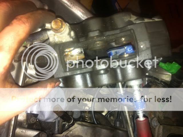

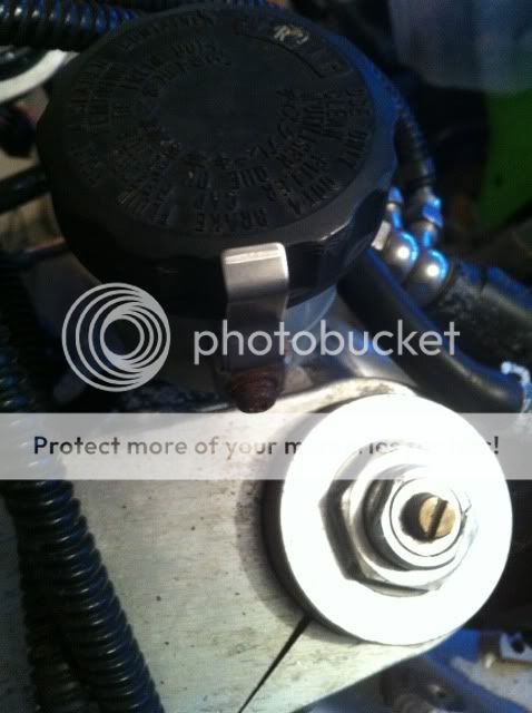

The other set started off more promising but...
https://i35.photobucket.com/albums/d170/tristanthe/Snapbucket/BEB8C097.jpg
When I came to top up the reservoir the screw wont wind out. So either the previous owner overtightened it and fucked the plastic thread, or it was fused together with corrosion.
Not a productive evening. Everything is broke.

Best thing you can do with those calipers is stick a set of 4 pots on. Seriously the 6 pots are rubbish.
plus the seal set is £60. I'll probably end up getting two sets of 4 pots, but in the meantime I'll still get these stripped down. I doubt I'll have 24 good pistons anyway so I'm defiantly looking for at least one set of 4 pots
doing two projects at once involves weird numbers, 32 valve clearances, 8 spark plugs erk

Tristan. wrote:
yeh your dust seals have done exactly what most of mine had done, if you have any bits of random rubber laying about, get some grips and put the rubber on the jaws, and see if you can pull the pistons out by hand. Shouldnt mark the pistons
Tristan.
Joined: 26 May 2007
PostPosted: 19:11 - 20 Mar 2013    Post subject: Reply with quote
Half the pistons are still fully recessed in the caliper bodies. not a problem, I'll try to get them out pnumatically at first, then split them and use my slide hammer for the rest. I've already got one set of bandit 4 pots in my sights, and tbh I'll probably get 2 sets.
bacon
Joined: 09 Jan 2009
PostPosted: 19:25 - 20 Mar 2013    Post subject: Reply with quote
Tristan. wrote:
its worth the investment mate, they don't go for much, finding them is the harder part.
Search for all the different bikes that had them, slingshots, bandit 12's etc, mine were badly worded on ebay, meant barely anybody bidded on them.

lol found the thread I made with the condition of my tokicos, I wish back then I had an ultrasonic cleaner, they would have prob come up cleaner than a toothbrush and brake cleaner managed!
https://www.bikechatforums.com/viewtopic.php?t=194978&highlight=tokico+caliper
