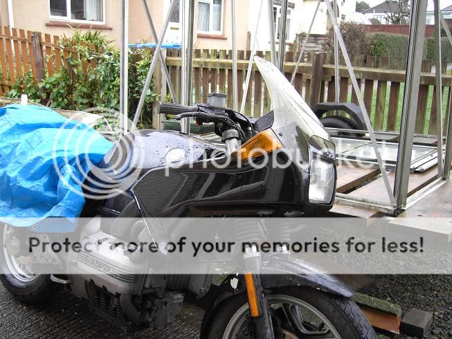

I got home Sunday night having had this following me all the way back:
https://i834.photobucket.com/albums/zz267/pdg555/k75s/first_zpsa950c78b.jpg

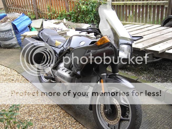

A few jobs immediately obvious to attend to, the seat being one Wink but this is what happened after a bit of a wash...
https://i834.photobucket.com/albums/zz267/pdg555/k75s/washed_zps1c9254c8.jpg

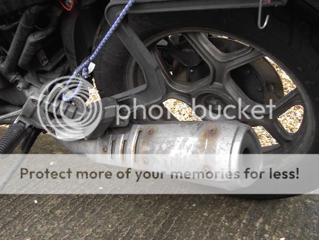

And, a bit of a before and after on what I believe to be the original (so 25 year old) exhaust
https://i834.photobucket.com/albums/zz267/pdg555/k75s/before4_zpsfa58b494.jpg
https://i834.photobucket.com/albums/zz267/pdg555/k75s/after4_zps7f413745.jpg
Guess that's what happens when a manufacturer decides to outfit a bike with a full stainless system from the factory...

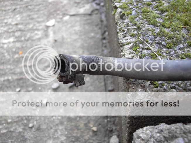

Had a look at the expansion tank hose - could only get fuel grade in the correct bore size but it fits and it'll work just fine so I started to get it fitted. Had to move the petrol tank (because the radiator cap and hose connections are under it) and found the fuel hose was looking a bit well used as well...
https://i834.photobucket.com/albums/zz267/pdg555/k75s/PICT0783_zps60c15e55.jpg
I wondered why there was a bit of a whiff of petrol sometimes - that'll be why.

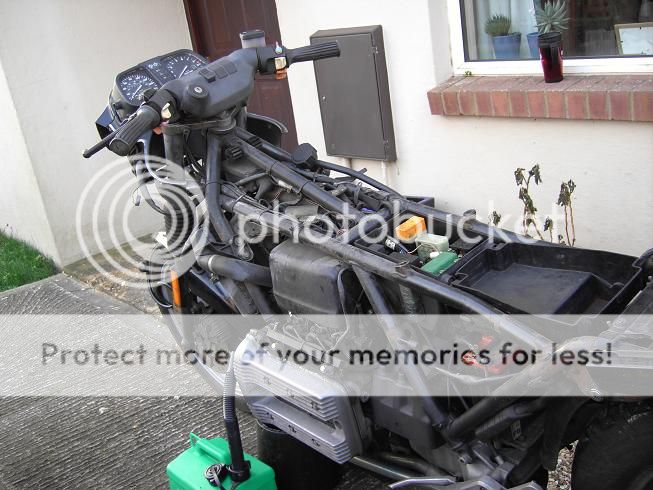

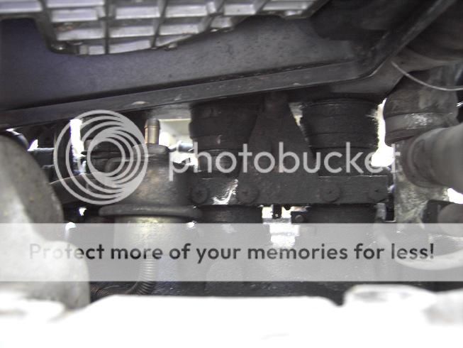

It's only the return line that's bad, but while I'm in there it seems sensible to just replace the lot. So I started getting the fuel lines out and the return line passes between the plenum chamber and air box. Didn't think it would be much of an issue to pass the pipe through, but wiggling one end didn't move the other - time to check the manual...
Turns out the pressure regulator is tucked in there too:
https://i834.photobucket.com/albums/zz267/pdg555/k75s/PICT0786_zps079524e0.jpg
Can you see the regulator?
https://i834.photobucket.com/albums/zz267/pdg555/k75s/PICT0785_zps32bc61c3.jpg
How about now? Talk about a pig to get to... These pipes haven't been replaced from new I reckon - still had the crimped hose clamps, not jubilee clips.

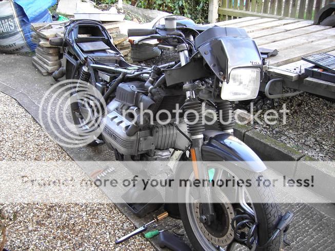

Still, not a huge problem - snip off crimps, replace pipe, job's a good'un. Only slight issue is to make enough room for tools and hands you have to make the bike look like this:
https://i834.photobucket.com/albums/zz267/pdg555/k75s/PICT0782_zpsf5bc856a.jpg
https://i834.photobucket.com/albums/zz267/pdg555/k75s/PICT0784_zps3d862b91.jpg
I could've got away with taking slightly less off, but I wanted to fix a couple of the fairing mounting lugs while I was there.
Also, I was sure I had more pipe... And a load of the right size jubilee clips... Looks like it's shopping time.
Now all I have to do is get it all back together - then find out I have to take it all apart again to fix the next thing Wink

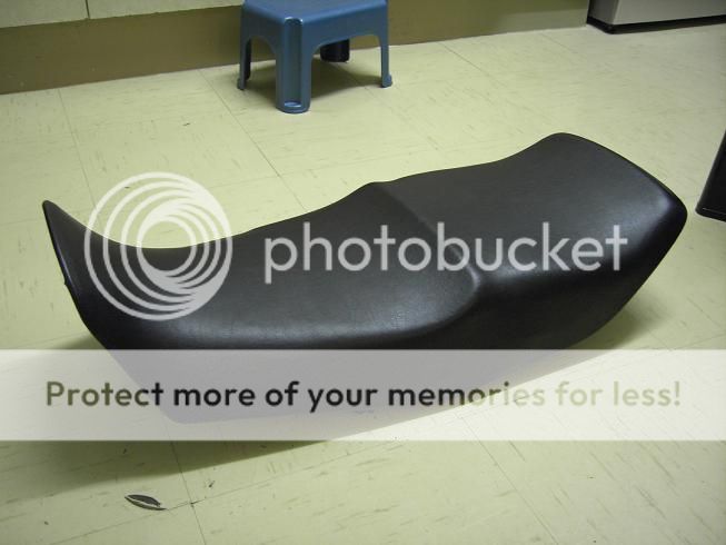

The seat had definitely seen better days:
https://i834.photobucket.com/albums/zz267/pdg555/k75s/PICT0788_zpsa1d35468.jpg
So, a trip into town to visit the fabric shop saw me buying some vinyl/leatherette type stuff. A while of pulling and gluing and I ended up with this:
https://i834.photobucket.com/albums/zz267/pdg555/k75s/PICT0799_zps7a45f1d1.jpg
I'm pretty pleased with how it turned out, cost me £3.74 for enough material to do 2 seats this size. It's thinner material than the original so may not last as long but for the price...

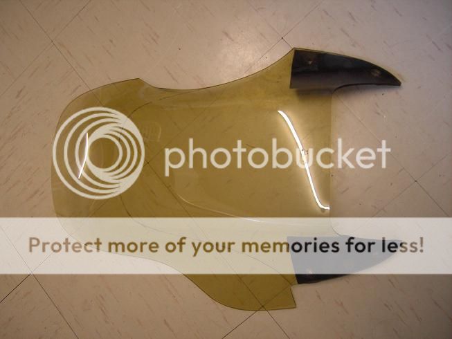

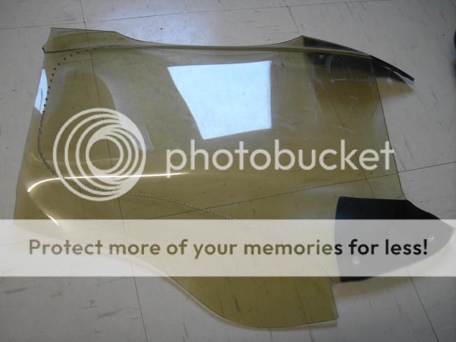

Another thing that needed a coat of looking at was the winscreen. There was a big chunk missing from one side where it got dropped during an attempted (and thwarted) theft.
https://i834.photobucket.com/albums/zz267/pdg555/k75s/PICT0795_zps6c7ae773.jpg
Rather than spend a bucket of money buying a new one I thought I'd cut it down a bit to even it out. Anyone who's tried cutting perspex type plastic before will know how much it loves to split and crack if you try sawing it (tiniest bit of swarf catches on the blade and it splits out) especially if it's a bit old - secret is to drill a few holes around the cut line like this -
https://i834.photobucket.com/albums/zz267/pdg555/k75s/PICT0796_zps1a25fdc6.jpg
If you can get all the holes to almost meet then it's simple to snap off the bit you don't want. It looks really yellowed in these pics, but out in daylight it's pretty much alright enough.
Anyway, after a bit of filing and sanding the edge and fitted it doesn't look too bad or out of place.
https://i834.photobucket.com/albums/zz267/pdg555/k75s/PICT0798_zpsafb02fbc.jpg
